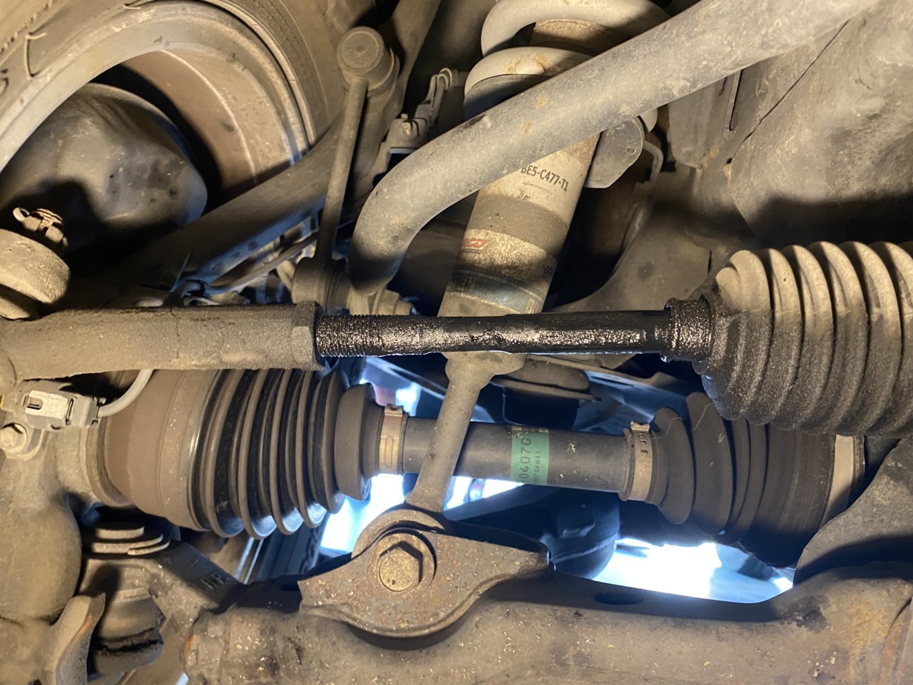

    Sorry for the vague subject line, I’m not sure what part this is but I don’t think it should be this greasy. Maybe the boot someplace is bad, but I’m unsure of how to go about inspecting/correcting.

    Inner tie rod bellows. The rubber boot is the bellows, the part inside of it is an inner tie rod which connects to your steering rack and pinion. The leak is steering fluid from the rack and pinion.
    Step 1, check your steering fluid reservoir and top it off if low.

    Looks like your power steering rack is leaking. Check inside the steering boot. Probably full of oil
    most likely need a steering rack

    Needs a rack

    You will indeed need a new rack but there are many issues with buying them from online auto parts vendors or your local auto parts store: they are Chinese crap and they WILL leak again. Worst of all, they require your steering rack as a core, so you get a Chinese $150 unit and they get a $400 OEM unit to remanufacture.
    The absolute best option hands down is to find a reputable local rack and pinion shop and ask them to rebuild your factory unit.

    For what it's worth it's entirely normal to have some power steering fluid in your bellows; some fluid always leaks by even on brand new stuff in racks like these the bellows catches the leak but the fluid can deteriorate and seep through the bellows and look like a bad leak when it's just a tiny one that's been there since it rolled off the line.
    Were talking a few tablespoons in each boot over years though.
    That said this may not be the case with OP, and generally speaking if the boots are worn out and oil soaked enough to need replacement it's probably an old enough rack to just need rebuilding anyways but what I am saying is if money is tight inspect the boot for condition and any dry rot cracks tears or punctures as well as fluid level and if everything seems okay just replace the bellows for a bandaid.
    I just did inner tie rods on my 2010, rack had never been serviced before, 240k mikes, I had had a strange knock in what sounded and felt like the front suspension but turns out was one of my inner tie rod ball and sockets. When I pulled my boots though there was no indication of leak but I dud have maybe between both sides a 1/4 cup of ATF in the old bellows, which I replaced also since I was there.

    My power steering fluid reservoir seems normal based on the level, what does that mean in terms of severity of the issue?

    It means you can drag it out for quite a while. I would pull the boot back and thoroughly clean out all of the fluid and monitor from there. Your power steering fluid does need to be flushed though, based on that color.

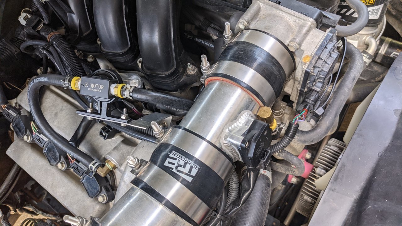

    Just FYI those hose clamps on your intake do not tighten evenly and the can allow small amount of dirt in at the couplers and small amounts of unmetered air to bypass which can can cause issues.
    I recommend getting some Vibrant T bolt intake clamps to replace them.
