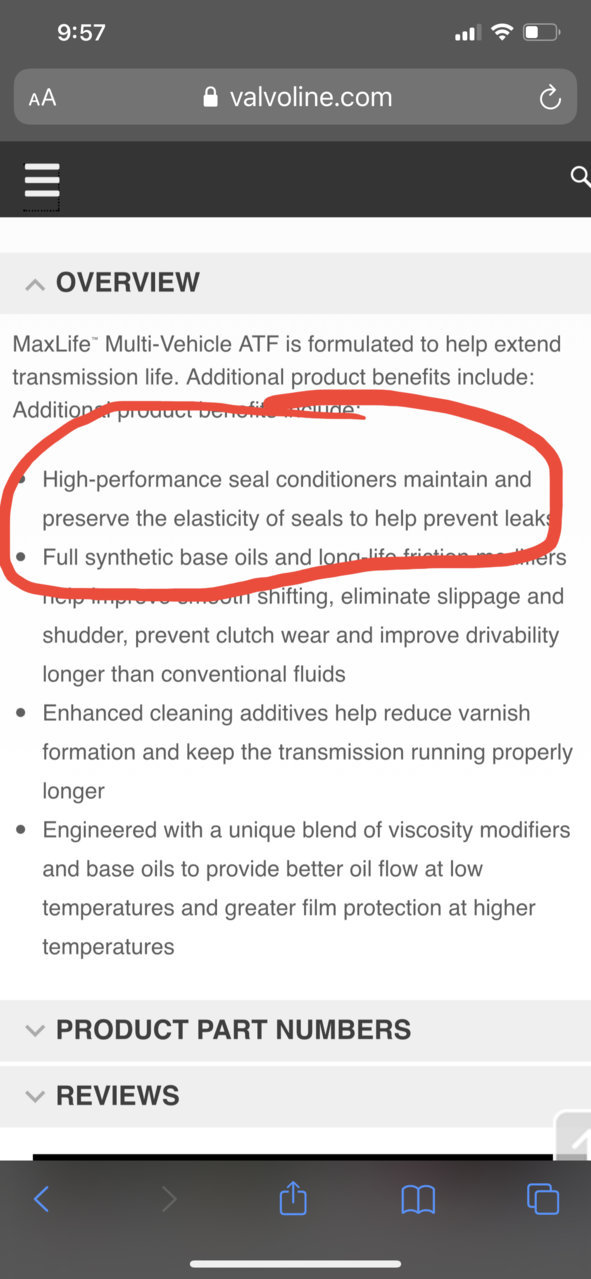

    honestly I don’t think it will make a difference. I flushed my PS out last year with Valvoline Maxlife ATF and it looks like the passenger side boot is leaking more than it did before.
    2007 Tacoma.
    however my fluid is sitting at the minimum line on hot after a year.
    boot is still wetter than before though.
    I just assumed every 2nd gen Tacoma has seepage from these boots.
