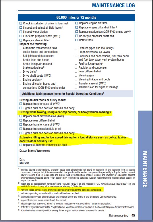

    Incorrect at 60k it says Driving while towing, using a car-top carrier, or heavy vehicle loading, extensive idling and/or low speed driving for a long distance such as police, taxi or door-to-door delivery use as the conditions. So if I never do those, which I don't, the transmission fluid will last forever? My blackstone lab report says differently. That's some bad info those engineers put out.
    edit
    Also if read footnote 3 on the page it says "3 Perform these service items only if you drive primarily under the conditions indicated". So being stuck in traffic occasionally or towing once a year doesn't meet those conditions.

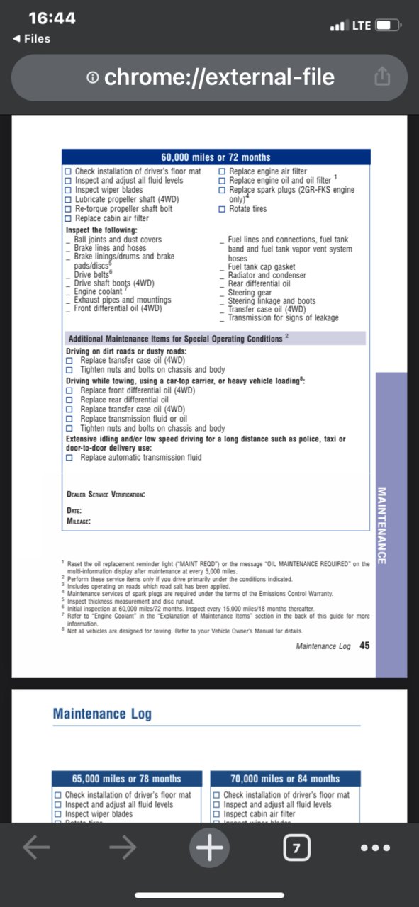

    Some people take everything so literally. I mean you really don’t need to be a cop taxi, delivery driver to fall under this special service requirement. Even your own testing confirmed this.
    If anyone actually believes WS trans fluid will last for the life of the vehicle, they deserve to pay for an early rebuild on their transmission. I also have some beach front property in Colorado at 7550’ of elevation.

    "Shrugs" not what mine says still the same engineers put it out..... thats some bad info right thereCapture.jpg
