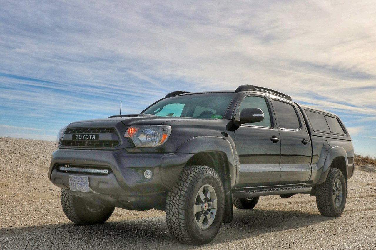

  16. Feb 28, 2018 at 11:23 PM
    #16
    motorgoat
    motorgoat Active Member
    Jul 26, 2014
    #134749
    30
    Chesapeake, Virginia
    2010 Prerunner
    hey what kind of lift do you have?...good looking truck btw

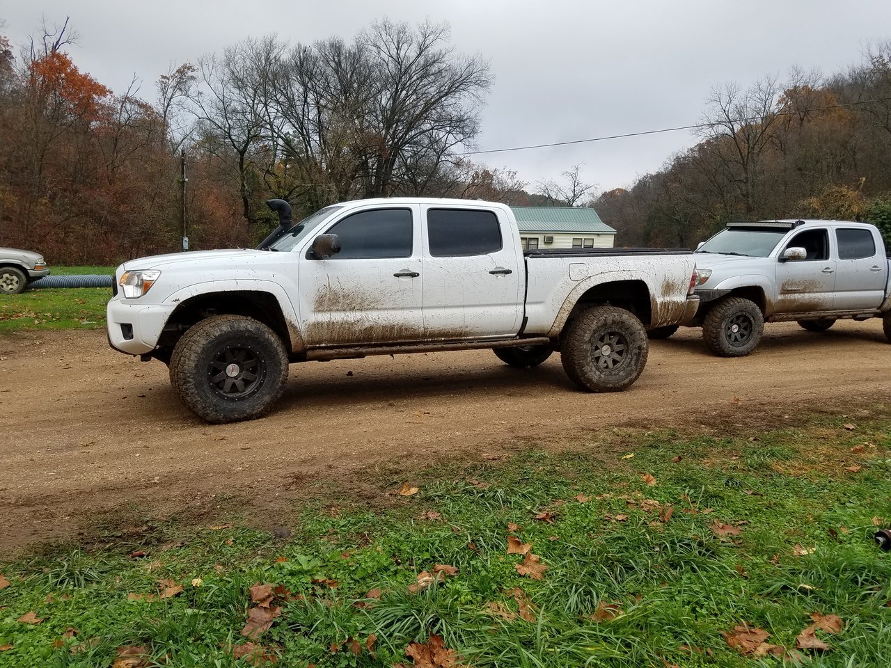

  17. Feb 28, 2018 at 11:31 PM
    #17
    MO Tacoma
    MO Tacoma Well-Known Member
    May 19, 2014
    #130189
    758
    Steve
    Castle Rock, CO
    2014 DCLB with a couple mods
    ADS extended travel, 14" 700 lb springs, Total Chaos UCA/LCA, Dakars. 37/12.50r17 Pitbull Radial Rocker. SCS 17" SR8. 4.56s with f&r ARB lockers. Relentless sliders, full skids, debadged. 35% tint on all windows. Katzkin leather w/ heated seats
    I'm running 2" maybe 2 1/4" lift in the front with 35s. I took 2.5" to 3" off of the finder. Beat the pinch weld back and cmc. Barely rub when fully stuffed.

  19. Mar 1, 2018 at 4:25 AM
    #19
    BigBiscuit
    BigBiscuit Well-Known Member
    Dec 4, 2010
    #47162
    453
    Mass.
    2010 TRD Sport DCSB MGM
    Thanks. It's nothing too special, but I like my truck just the way it is.
    I have Toytec Ultimate's up front which are adjustable and use Bilstein shocks, and a Toytec AAL on the rear.
