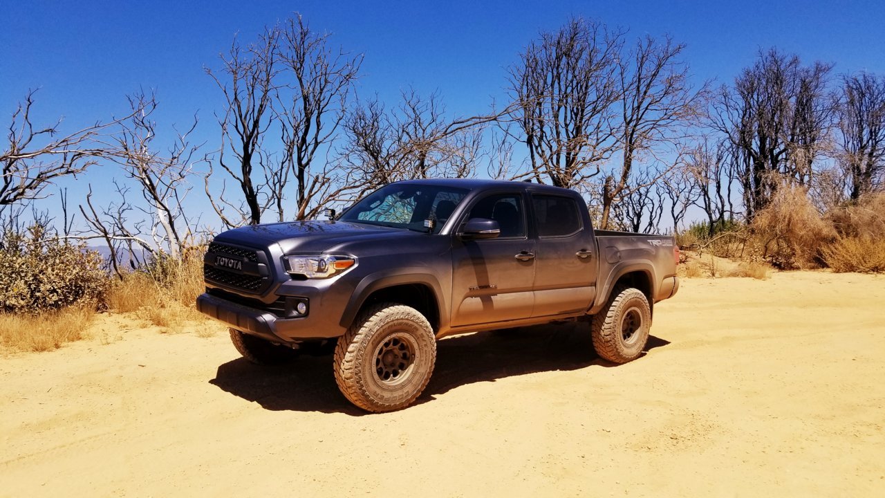

    Specs of my build are below, but what I really am having a hard time understanding is the consequences of rubbing. It goes without saying that it generally isn't a good thing to constantly rub your tires against a fender well or a cab mount, but what I have yet to see is a story of a Tacoma owner who suffered any loss from rubbing on a 3rd gen. I recently installed my lift, wheels, and tires. Periodically I'll get that noise from rubbing. So far it has been 3 times. Once while wheeling and twice pulling into a gas station. Hitting your pinch weld or rubbing your cab mount is unnerving for sure, but is anyone really damaging their tires or risking their weekend joy by rarely rubbing to the extent doing these modifications are necessary? I feel as though a quarter inch more of clearance, I'd be good to go and I'm willing to explore these options, but just looking for some perspective.20180806_045009.jpg
    OME 888 Coils
    5100 @ 0 setting
    5100 rear
    Dakar Medium Leafs
    Icon Tubular Upper Control Arms (Delta Joint)
    255/85r16 ST MAXX
    SCS Ray 10 (16x8, 4.5BS, -12mm Offset)
