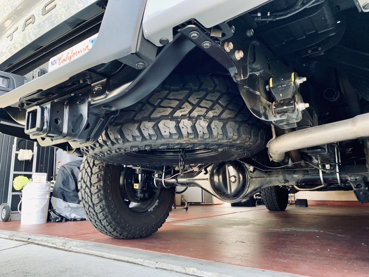

    Not hard at all. Tight but gooooood!!

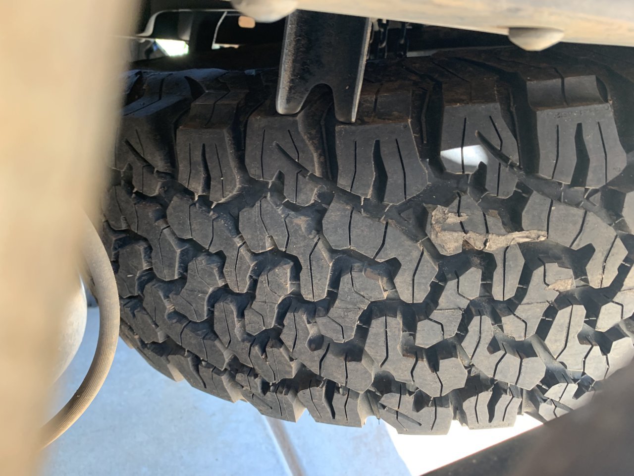

    Best option, ill find some pics I took, it will fit and clear the exhaust but not well with the brackets contact point unless they are bent.
    Edit: pictures from before the bend

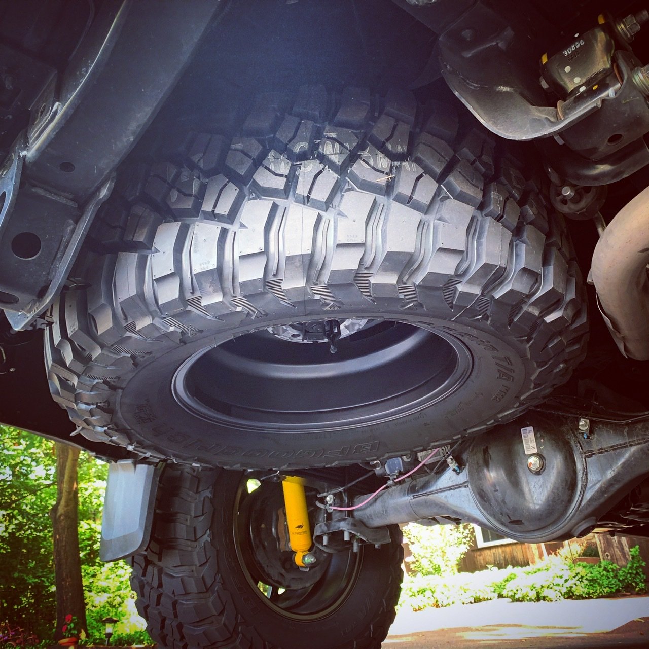

    178
    2019 MGM Tacoma TRD Off-Road
