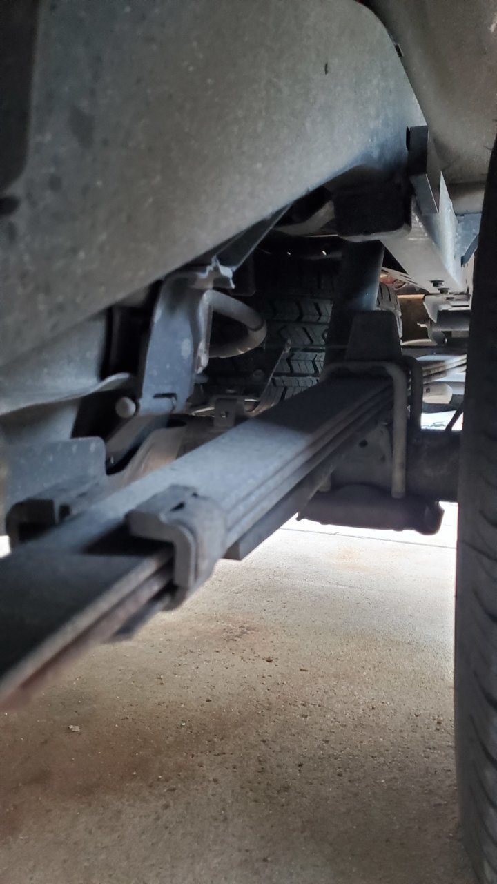

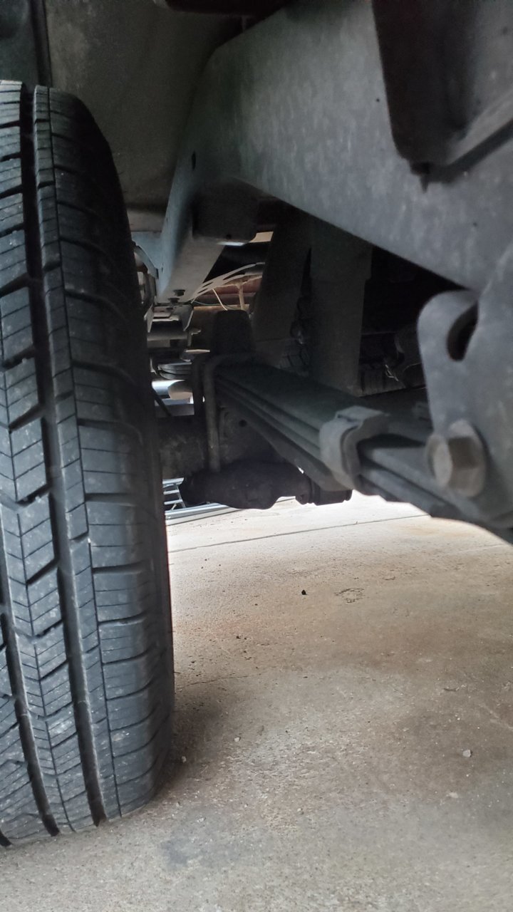

    How bad are my leaf springs? I don't really notice bad ride quality, but i upgraded to this truck from an '84 pickup that also had shot suspension, so that might not be saying much. I've had a little over 500 pounds in the bed and didn't notice any issues with it bottoming out. Previous owner claimed "never used for towing" but had 3 giant boats in the yard :(...am I good to ride like this for a while until i can upgrade? Or should I move this up on my priorities list? Also, any recommendations for replacements? Thanks20230914_185022.jpg 20230914_184956.jpg

    I think you're fine to run em like that for awhile. Plenty of room before bump stop contact. The only issue I've experienced with worn suspension on these trucks was in a friend's 01. He had a tendency to overload the truck and that combined with clapped out stock suspension led to some speed wobble at times at freeway speeds.

    If you’re not hitting the bump stops in your daily uses, you still have some time. Worst case your bump stop plates on the frame cave in.
    If you snag leaf springs from the junkyard you may be able to slip one into your existing pack to add some capacity.

    They're frowning and damn close to needing replacing. Especially as old as they are since they look stock.
    Just buy a new set and replace them, really simple.

    Looks like what I recall mine looking like over 10 years ago, and I only upgraded to lift it.
    Your shocks are most likely done though. When I took mine off they held their position and didn't extend on their own

    It can go for awhile . Just keep a watch they don`t break they like poking holes in tires and fuel tanks.

    Unless they’re cracked or rotted you don’t really need to replace them. I wanna replace mine just to get the rear higher than the front.

    Constant load (and dampening as your shocks wear out from doing this) causes a leaf pack to lose it's arc and support weight as it should.
    Could pay a shop to rearc them but a replacement pack is affordable; so yes either replace or refurb. Otherwise it does get worse and does warrant addressing them even if they're not rotted or cracked.

    These first gens always seem to have a little frown in the leafs. They should be replaced but they aren't currently a safety hazard. That frown will cause accelerated wear though.
