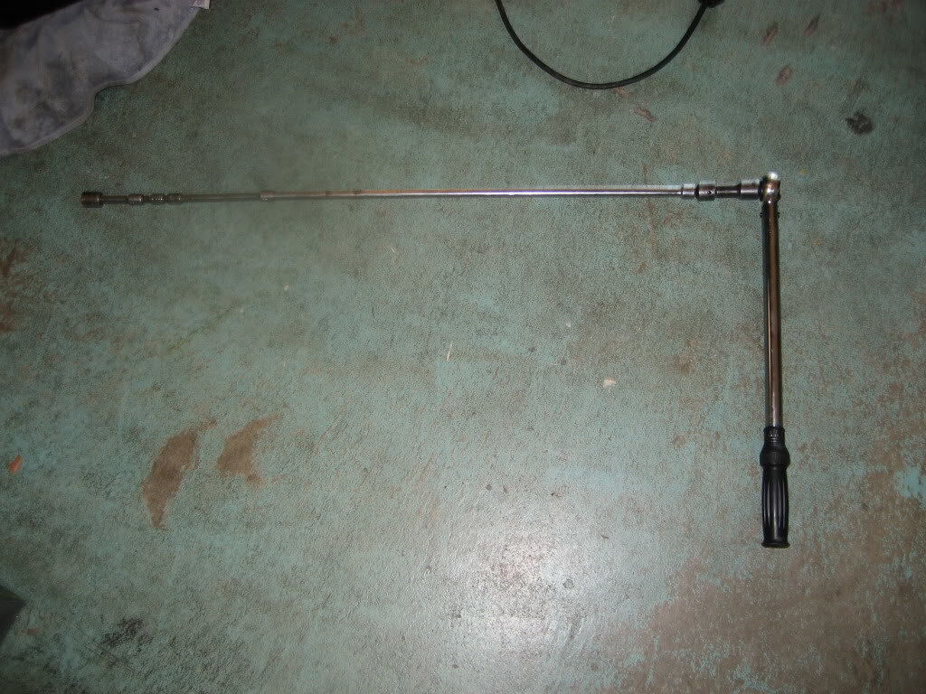

    Before I commence with today's reefing, I'd like to ask you all if all 6 (per FSM) of the engine to tranny bolts are 17mm heads.
    I have accounted for 4 17mm bolts (the two top, hard-to-reach bolts requiring obnoxious extension combos, the one above the slave cylinder pointed out to me, and finally the long one on the passenger side that also secures the exhaust pipe brace.)
    Are the remaining two mounting bolts the longer of the 14mm head bolt/nut combos which I already have removed?
    If after all this time searching around the bellhousing I have missed two more 17mm bolts, I'm giving up and bicycling the rest of my life.

    Here hope this helps show where the bolts go or should be..
    93ab4299d0b4c56487be0fb15a490cd4_zps7455_365dddf7eb0599bc412727590477e87b5d11931b.jpg
    there are 6 17mm i believe.

    Definitely more than 4 bolts, I'm an auto but I used a 1/2 drive swivel 17mm socket with a bunch of extensions to get them, pita. At least you don't have to unbolt the torque converter from the flex plate, that's annoying

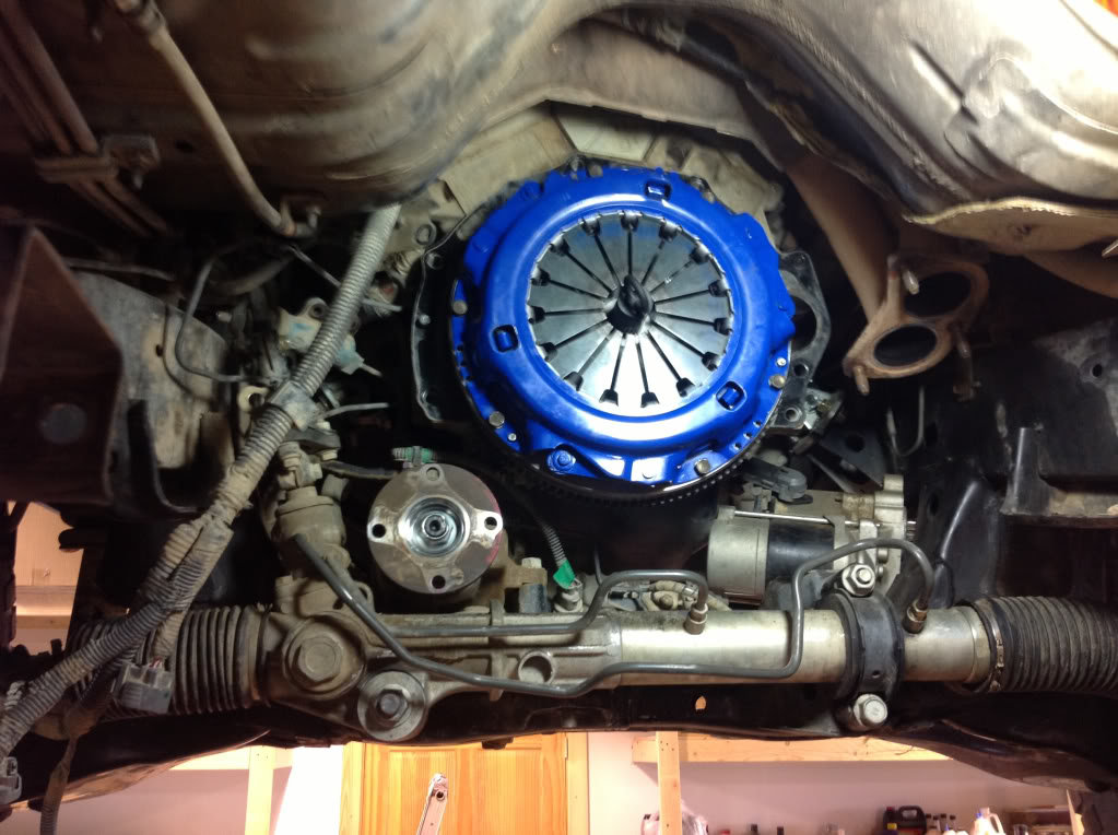

    Can somebody tell me whether the new throwout bearing assembly is correctly installed? Some beer may have caused me to forget the original orientation of the clip.
    I assume when everything is back together that the clutch will hold the fork/bearing tight, but the clip, as installed, seems excessively rattle-y.

  17. Dec 3, 2013 at 4:40 PM
    #17
    TBeers
    TBeers Well-Known Member
    Apr 9, 2013
    #101708
    63
    Montana
    Tacoma DLX 3.4 4x4
    What kind of clutch did you install? Looks like an F1? Hows it holding up/acting? Mine's starting to slip, i'll be in your shoes not too long from now.
