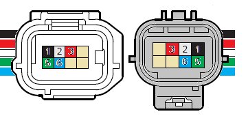

    Update: I got my 8 pin connector in and the Natika backup camera. Using the wire diagram provided I did a test to see if it would run off the factory plug without having to find 12v power from another location and bam it worked. I cut the RCA cable and wired straight to the 8 pin as well. Now I gotta install it and make it pretty.

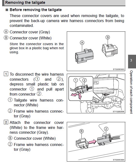

    Excellent. You should have the connector covers for the disconnected one.

    The 2nd Gen had them in the "glove" compartment, complementary. Can't see they charge you for a set since it's in the Owner's manual.

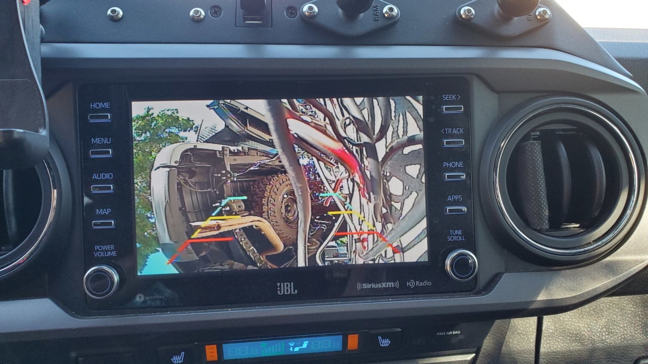

    Success! bought a pigtail and camera off Amazon, showed up in 1 day, connected 3 wires and now i have a backup camera for when i have no tailgate due to a camper.
    thanks for doing the legwork guys!

    From 4 slot connectors:
    to this:

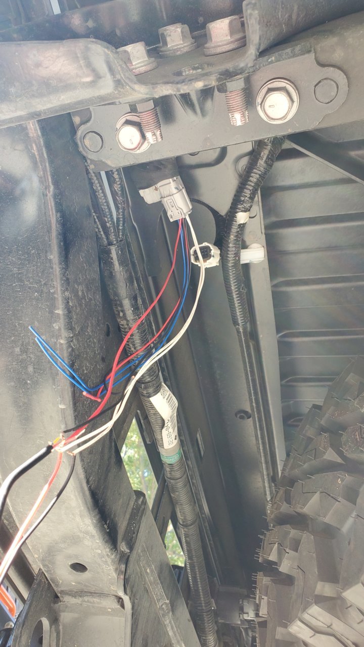

    I actually figured it out, ha. If you've got the 4 pin that I linked. You get 4 wires. Pin 1 - yellow, 2 - black, 3 - gray, and 4 - blue. That's with the clip/buckle at the top. Since the gray was the only wire with power, I connected the red wire from the Natika camera harness to that. Black with red stripe to the blue wire for ground? Then I clipped the AV plug and trigger wire off and wired those directly to the black and yellow wires. Red off the camera to the yellow on the 4 pin plug and yellow off the camera to the black on the 4 pin. Then I plugged it in to test. Worked right off the bat.
