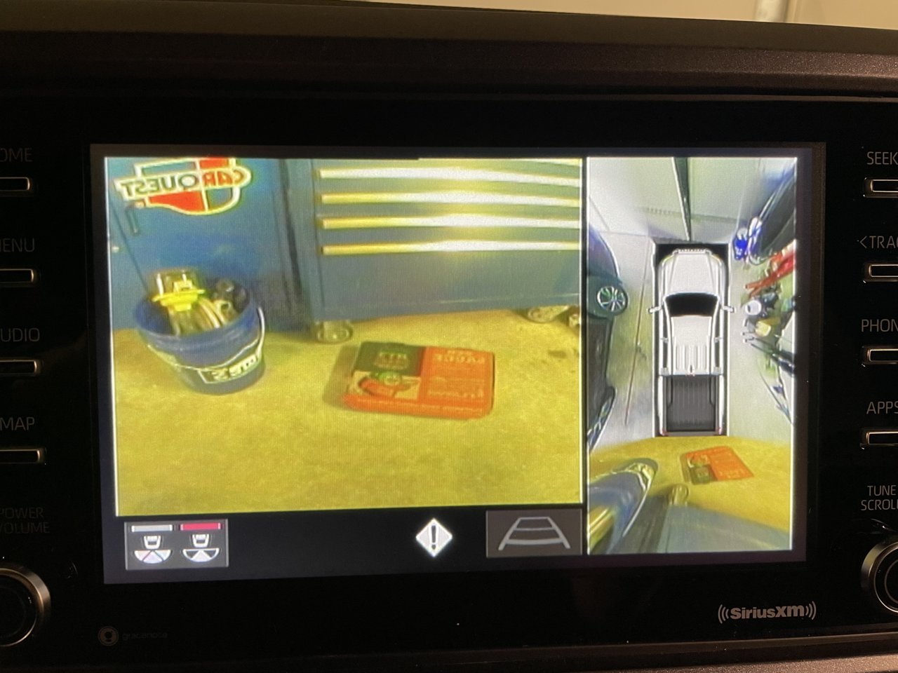

    Another install detailed here with the a panoramic 360 camera system. Thanks to @StapleNut @caribe makaira and @Blueberry.Taco for their discussion in this thread, which helped immensely.
    Abbreviated version:
    - Parts described in this thread were used
    - I found cheap female and male connectors here: https://www.aliexpress.com/item/32918483654.html
    - Not sure what the repercussions are of leaving the CAN BUS disconnected at the OEM truck-side connector, but for now everything works normally

    I'm a bit confused by this picture. It looks like the numbers are pin position. Are the colors compatible between the two connectors? For example, is #1 on the 8pin equivalent to #4 on the 4pin?
  20. Feb 23, 2022 at 4:01 PM
    #60
    shaggy135
    shaggy135 Well-Known Member
    Jan 18, 2019
    #279785
    2,062
    Valley of the Sun, AZ
    2019 Barcelona Red TRD 4x4 OR DCSB MT
    I posted the 4 pin layout on page 2:
