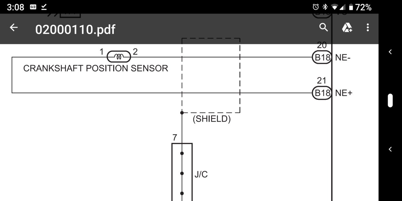

    You could check the crank position sensor at the ECM with an ohm meter
    @DoorDing 's 2nd link has the resistance values. If it's outside that range, they say replace it.
