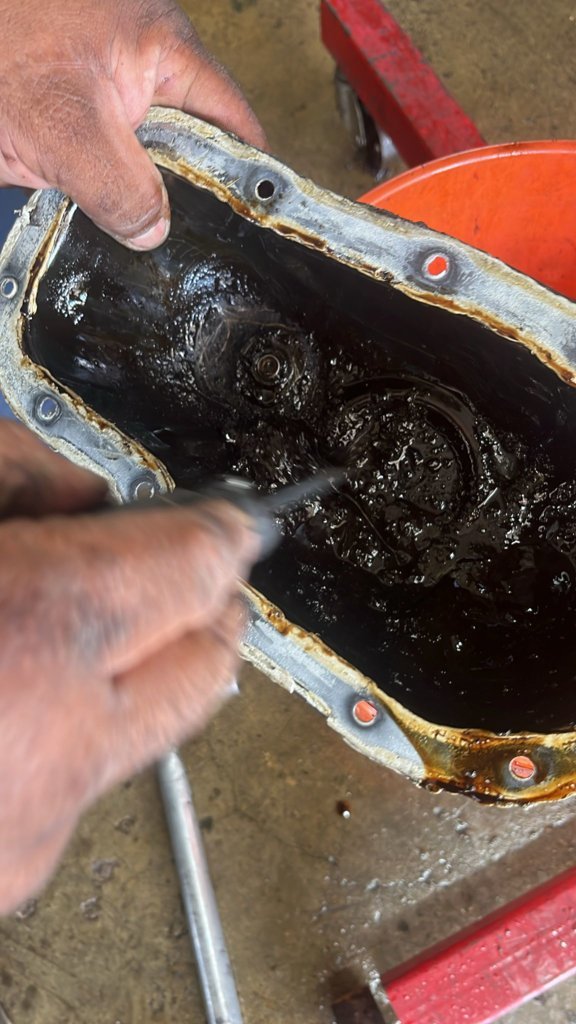

    Doing some cleaning.

    That's crazy, I thought it was a coating of VHT wrinkle black spray paint at first glance lol.
    Also I'm confused at this point. First post is "how can I clean my dirty engine", then a bunch of people gave good suggestions of what to use and how to gently clean while mitigating risk of clogging the pickup, then you decided "I would not do anything to my dirty engine because it is running very fine. If I do something to it, it will get damaged. It will stay dirty and running fine!" and next thing you know you have a picture of scraping the inside of the pan to clean it.
