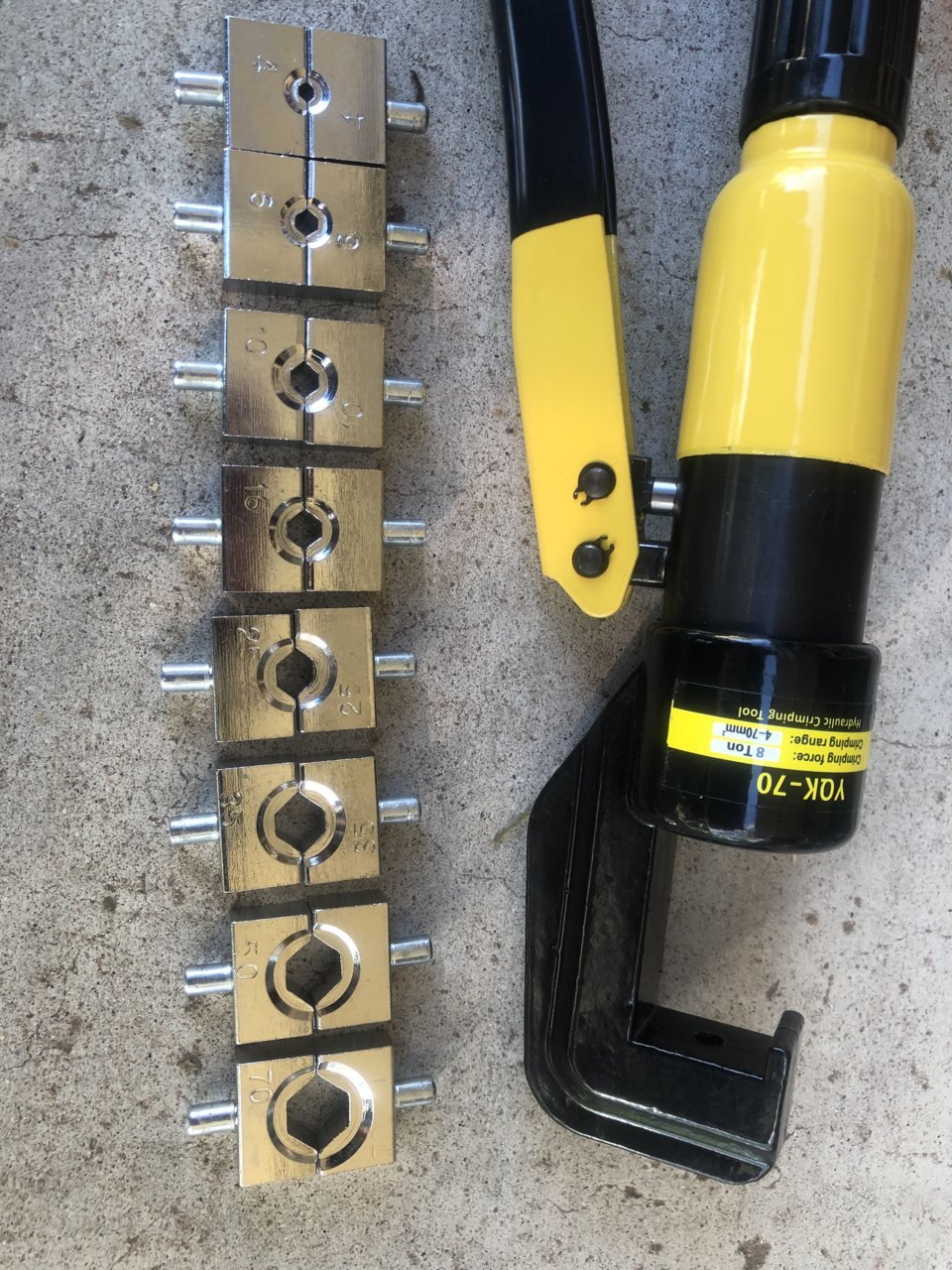

    Oh, just figured out the units on the dies- they represent square area (mm^2).
    For a copper 2/0 lug, I used the #50 die.
