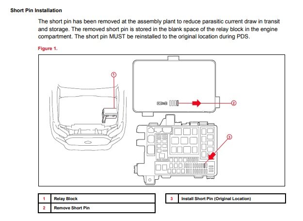

    Pretty sure the whole reason the “Short Pin” is there is for shipping.
    @Dm93 can confirm it.
    Not saying that’s the best approach in your case.
    But it maybe an option.
    Dm93 and Superdave1.0 like this.

    Predator tube steps, Ranch Hand grill guard, Magnaflow CatBack exhaust, Toyota tool box & bed mat, 2LO Module by @Up2NoGood, Rearview Compass/Temp Mirror, Tune by @JustDSM.
    That's exactly what it's for, it's in the PDI checklist.
    Note that removing it will clear keep alive memory in alot of the modules so things will need to be reset/relearned after it is reinstalled just like when the battery is unhooked.

    What if the shipping company doesn't reinstall the short pin? Any chance of damage?
  15. May 1, 2023 at 7:53 PM
    Bishop84

    Dm93
    Dm93 Test Don't Guess
    Mar 3, 2015
    #150066
    12,760
    Texas
    2014 DC OR 6spd 4x4
    I don't see why there would be, essentially all it does is remove the keep alive power from most of the modules on the truck.
    You would just have a bunch of warning lights on with it removed but the truck is meant to remain driveable with it out.
    Alot of newer vehicles have a setting the Body Control Module to change between Transport Mode and Customer Mode but Toyota and some others still use either a short pin or a fuse to be removed for transport or storage.
