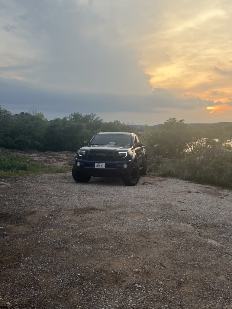

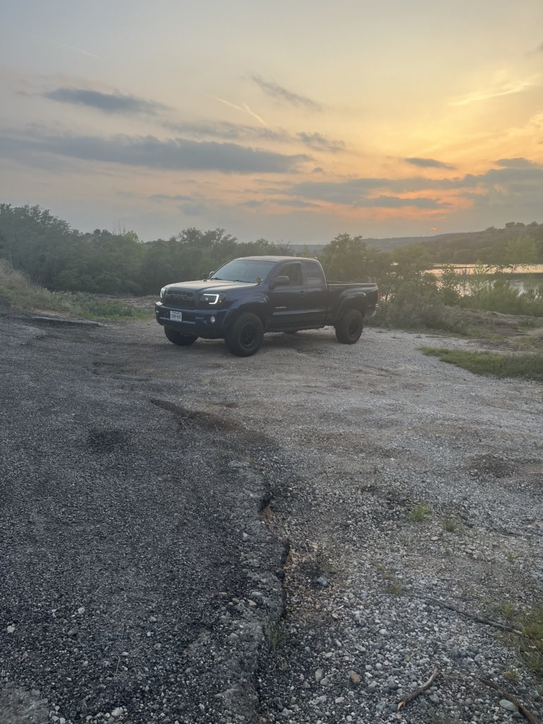

    I currently have a blue Tacoma (pictures at the bottom) and I want to copy this white Tacoma with its lift, roof rack, and wide body. (Pictures at bottom) I’ll be going with a rough country lift because I don’t feel like breaking the bank but everyone has told me not to go with a 6in lift. I’m still debating between a 6in or a 3in RC lift. Also I need tires to add on extra height. My wheels I just bought are currently still stock size so I’m confused on what tires to get.

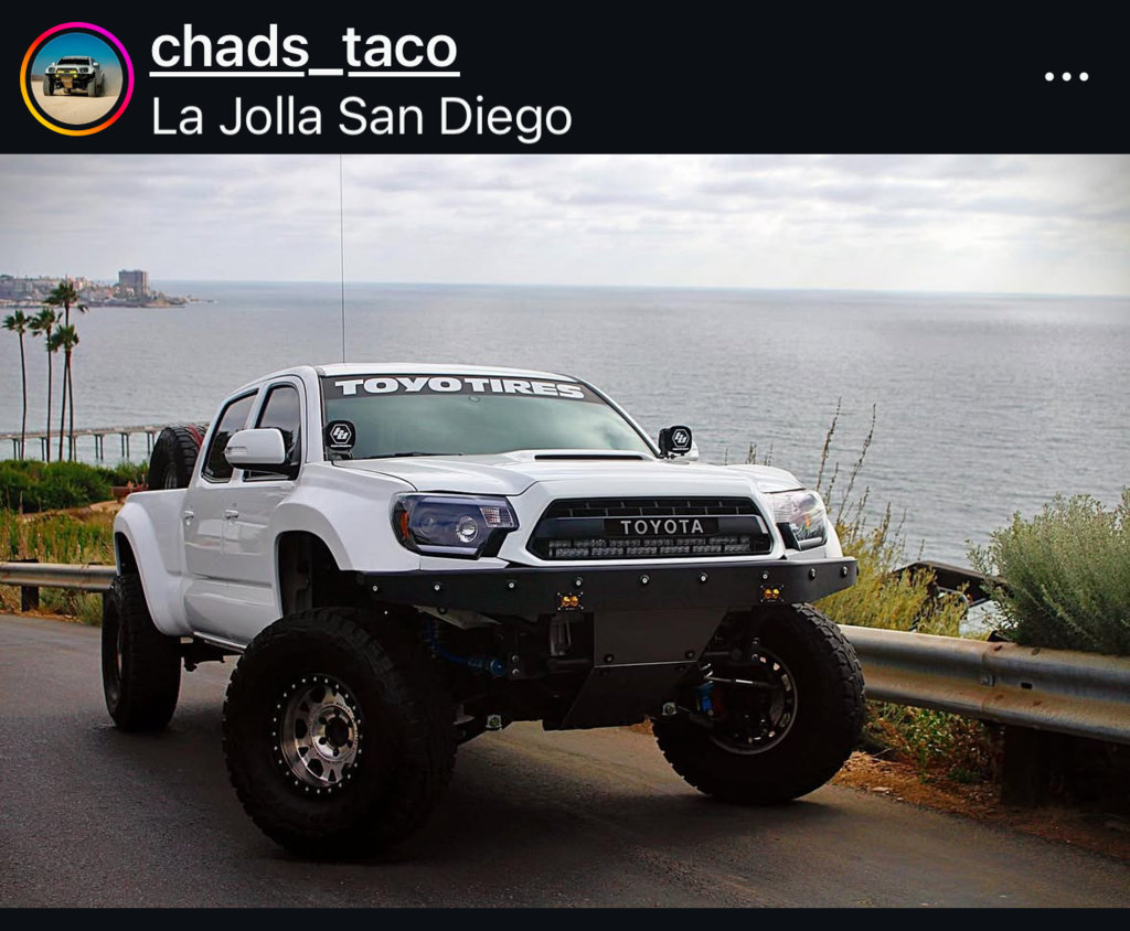

    That white one looks to be a long travel kit. All the flares will require a ton of body work as well. Paint is not cheap these days.

    The white one has LT kit & fiberglass fenders & bedsides.

    That white truck does not, in fact, have a rough country lift lol…

    That white truck is 2WD and on lift spindles (4", most likely) w/LT.
    OP, is your truck 2WD or 4x4? (if 4x4, the only way you'll be able to duplicate that stance would be LT with a drop bracket kit)

    Drop brackets are stupid and absolutely not required for LT and 37's. Do not recommend them.
    And no; the truck is on OEM spindles.

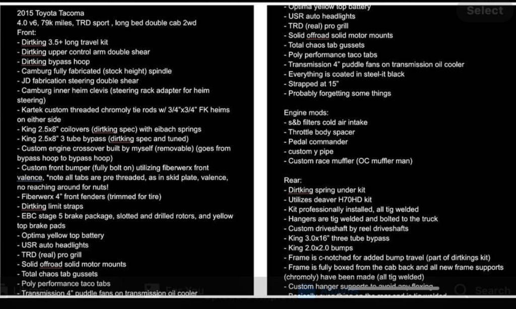

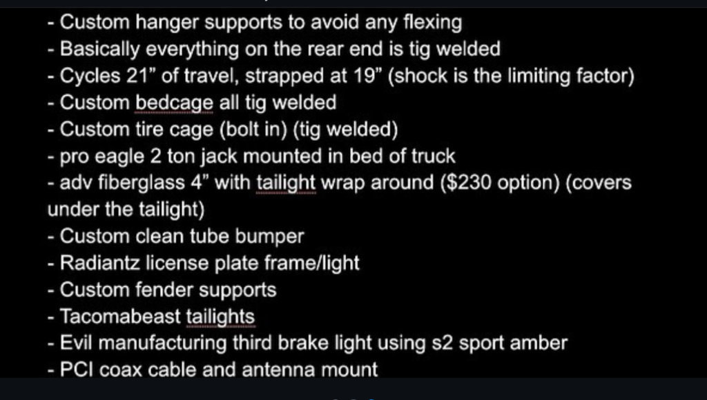

    https://www.instagram.com/chads_taco/
    (Not exactly the same truck, but pretty close)
    He's sold it, but as a lot of info on his IG for OP to copy.

    The LCAs on that truck are right at the same height as the center of the wheel hubs. Absolutely those are lift spindles.
    I won't disagree that DBs are not needed with LT, but OP says he wants that stance on his... If his truck is 4x4 (he hasn't said yet), that is the only way to achieve it since you cannot use 2WD lift spindles on a 4x4.

    His build. (See photos.) Those are not lift spindles. It’s a +3.5” LT kit.
    It sounds like you may be motivated by aesthetics over performance. If you don’t want to “break the bank” consider settling for 5100’s and tires.
    5100’s will give you a moderate increase in performance too. Rough Country will not.

    It looks like there may be some confusion as to who's truck that is... I clicked the link Naveronski posted, and of what little I can see of the truck without having an IG login, it is clearly a different truck (and no, does not appear to have lift spindles).
    The LCAs on the truck OP posted are clearly at the same height of the wheel hub (the tie rods similarly are well above the wheel hub centerline), and it looks to be sitting a good 5-6" above stock height.

    You may be right, I didn’t look too closely at the truck on instagram. Will take another look. But if he’s sitting on 35’s with a 3” lift that’s 5 inches above stock height.

    Yeah, not the same truck, but a pretty similar stance. Chad’s tires look a little bigger. You’re right about the level of the LCA’s and tie rods
