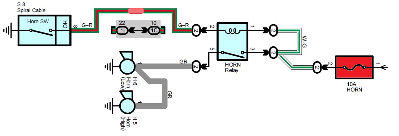

    Is there anyway I could use that diagram to turn his damn horn off? I don’t understand or know how to use any of the instruments. I’m not electronic dude.

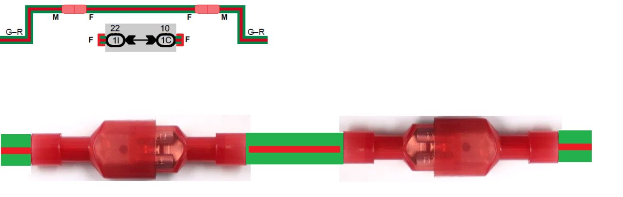

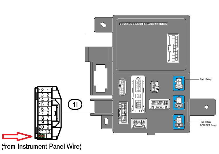

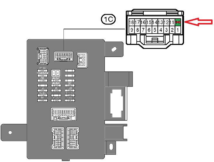

    Locate connectors 1I and 1C. The are connected to the Cab Junction/Fuse box.
    Identify the pin 22 on 1I and snip, strip and add an insulated female connector to the wire coming from 1I. The other end, strip and crimp a male connector.
    Identify the pin 10 on 1C and snip, strip and add an insulated female connector to the wire coming from 1C. The other end, strip and crimp a male connector.
    Measure the distance to the cut wires and cut a length of wire to reach. Strip and crimp, on both ends of this wire, a female connector. This wire mates to the cut wires.
    It'll by-pass the ECU Alarm ground. If later there's a need to return to how it was, then the cut wires will mate back to the connectors via the female & male connectors added.
