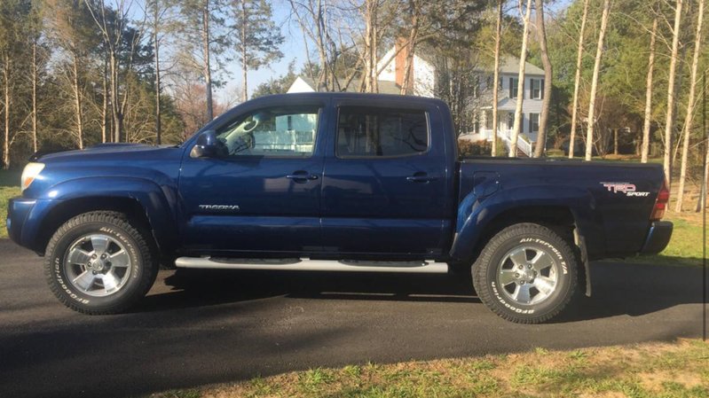

    I recently purchased a 2006 Tacoma and it came with 265/70r17 BF Goodrich All Terrain tires that will need to be replaced soon. I am selling my 2004 GMC Sierra that has 285/70r17 Nitto Terra Grapplers on it and would like to swap the tires between the trucks to avoid having to purchase new tires right away. I plan on purchasing a lift in the future (which I know would fit the 285's) but in the meantime just want to avoid buying new tires until that happens. What is the cheapest/best way to make the 285's fit on the Tacoma? Thank you all for your help!
