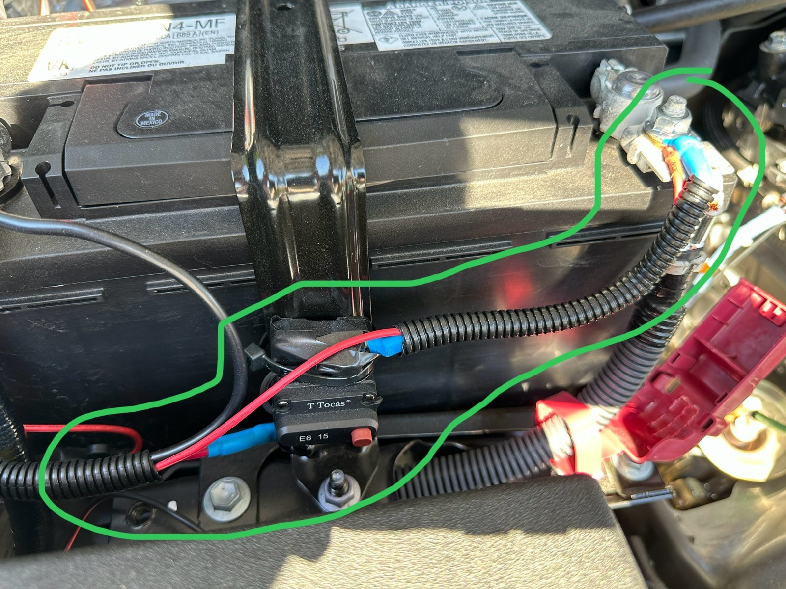

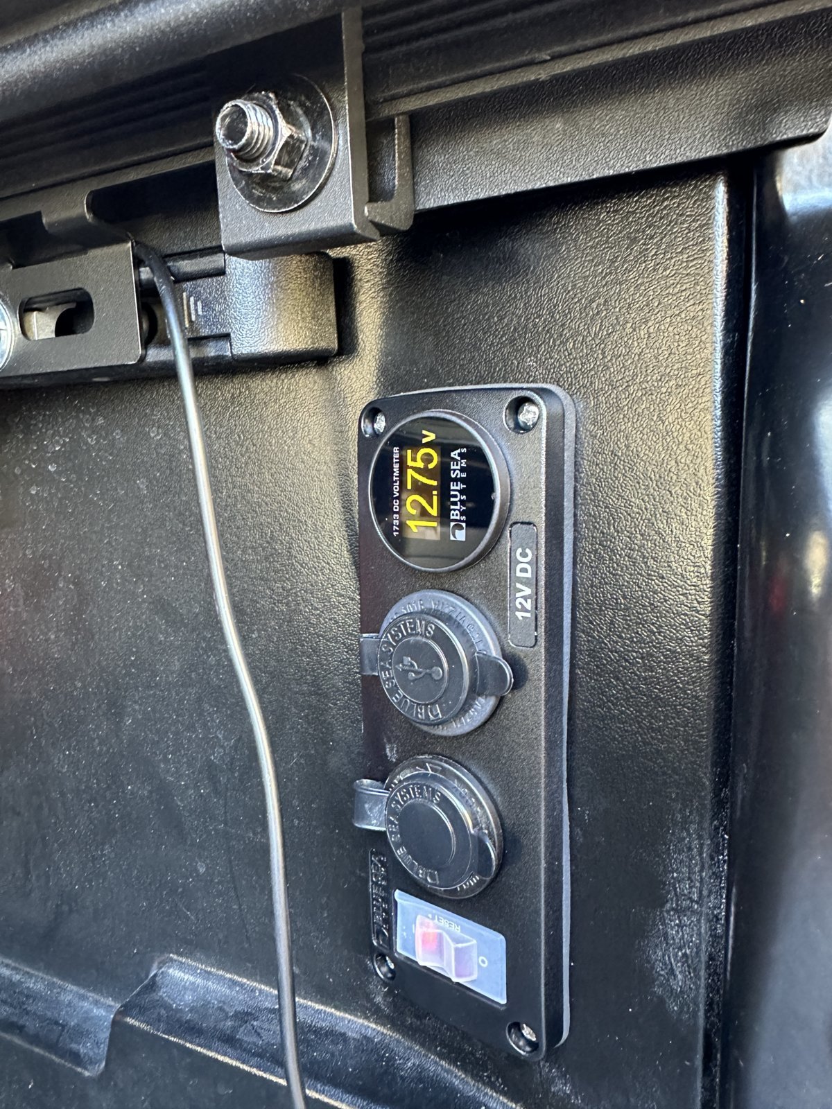

    I too was disappointed about no power in the bed without the upgrade package. Saw that OEM part and was hoping for plug and play, but seems dependent on additional parts to make it work. Wasn't worth the hassle or risk trying to find out.
    Went the DIY route with Blue Sea Systems 4366, 10 gauge running along the frame rail, 15A breaker near the battery. Like others mentioned need to remember to turn it off... I figure it's just a matter of time until I forget and kill the battery, but that's what the Noco is for

    This looks awesome and is exactly what I need! Can you send more pics of the breaker connection point (sorry I am new to diy electrical_)

    Snapped a few more photos for you. There are extra wires in the photo... Ignore the exposed red wire on top of the breaker. I temporarily ziptied the breaker to the battery bracket because I'm not sure what my long term plan is for cable/battery management. Not an expert by any means, but researching around made this seem like the easiest method.

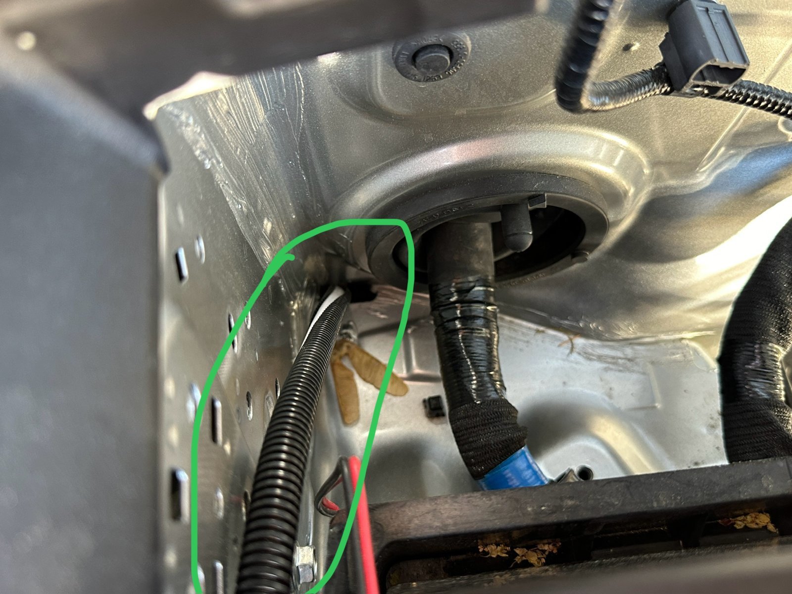

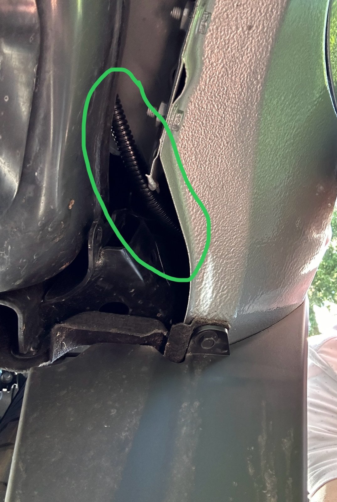

    Second photo shows where I fed it from the engine bay down toward the frame (behind front passenger wheel well). Third photo is where it popped out below to start following the frame.
    20ft of wire almost wasn't long enough. It took a good amount of time underneath the truck to run it along the frame as directly as possible to reach the rear passenger corner of the bed.
    In addition to the items below you'd also need wire loom and the appropriately sized terminal connectors.
    Blue Sea Systems 4366... https://www.amazon.com/dp/B07PP1V3L5?ref=ppx_pop_mob_ap_share
    10 Gauge Marine Wire,20ft 10 AWG... https://www.amazon.com/dp/B0C281M62W?ref=ppx_pop_mob_ap_share
    T Tocas Circuit Breaker 15A E69... https://www.amazon.com/dp/B0BZR8W6N2?ref=ppx_pop_mob_ap_share
