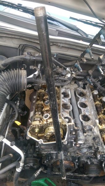

    I did it with the help of a 3' black pipe extension over the breaker bar. Hurray to the lever !!
