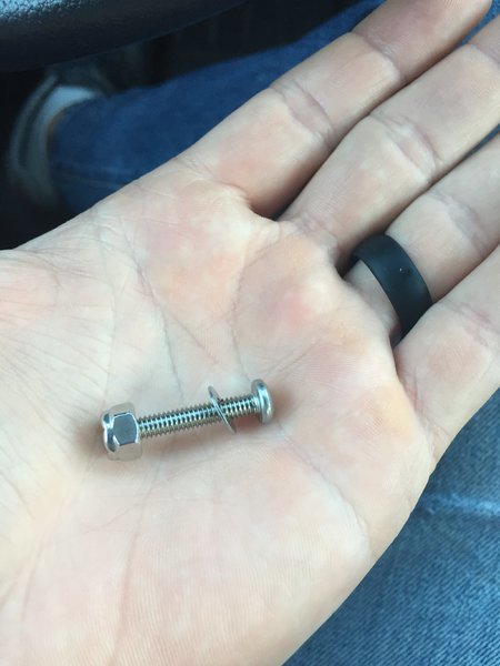

    irish_11, or anyone that has installed Proline tracks, did you use the mounting bolts that came with the Proline tracks?
    They're probably fine, but it appears that a heavier duty bolt could be used and it would still fit well within the mounting hole that is drilled in the tracks. Seems like an easy upgrade to strengthen the mounting hardware...
    Here's a pic of the stock bolt that came with the tracks.

    I used the stock bolts, but mounted 5 per side not just the 3 they had predrilled. I also added a fender washer on the inside to spread the load. I put silicone in the holes I drilled as well to seal it up. Its been a wet winter/spring up here so far and no issues.

    The good news is they upgraded the tracks from three to four predrilled holes. And yes, definitely going to be using a fender washer on the inside. Thanks for the feedback!
