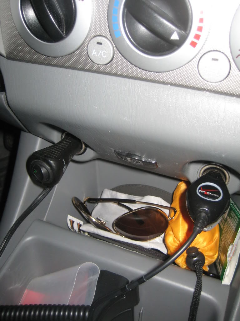

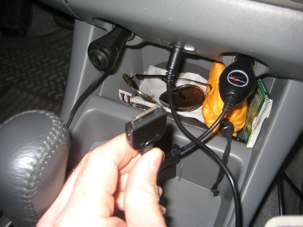

    This is what I bought:
    http://cgi.ebay.com/ebaymotors/TOYO...mQQptZCar_Audio_Video?_trksid=p4506.m20.l1116
    The actual item looks different than what's shown in the pic in the eBay ad....it actually looks like this:
    It's a little box that has both an aux adapter and a cable plug specifically for an iPod. It has a harness that simply plugs into the back of the factory head unit.
    I cut a hole in my console between my 12V outputs very carefully and painstakingly with a utility knife to fit the box (the box is a weird irregular shape so I traced the outline of the end of the box on a piece of paper, cut out the paper, and used it as a template on the plastic console for my utility knife cut).
    If you cut a hole for it like I did, you have to be careful to feel around inside the console panel (requires skinny fingers to fit back there) with the climate control panel removed. You need to feel for two ribs of plastic and make sure your hole is centered between the ribs. The adapter box is slightly wedge shaped, so cut the hole on the small side and then wedge the box into the hole from the inside of the console to get it to fit snuggly.
    I just glued it into my hole with some multi purpose quik bond adhesive. It worked out very nicely and sounds great:
    The ipod cable that comes with it plugs right in to your ipod and even charges it, and you can control the ipod remotely with your head unit and steering wheel controls.

    Metra Axxess box like in the pics above except mine is just behind the radio in the dash & the ipod/3.5mm aux cables are in the glove box. They have enough slack to hold device in pass or drvr seat to futz with. Base model here with no steering wheel controls. Paid 53.00 shipped off Amazon so I guess mine is the budget one. No ipod txt, just charges & plays. Mp3 player to 3.5mm cable just plays. Didn't hook up a grnd loop isolator so when charging mp3 player you have to listen to something else, if it needs charging. Mine run run long time. :D
