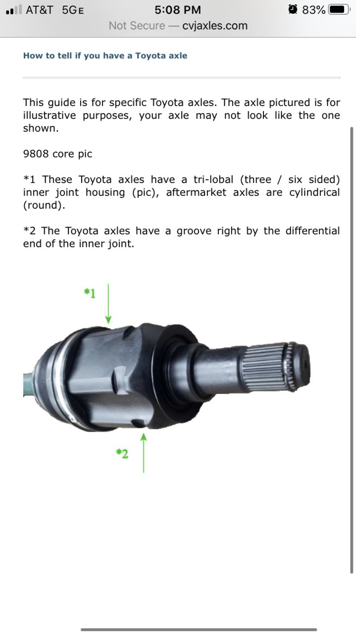

    Those grooves are a godsend for tapping the CV into the diff when putting them on, also for tapping them out of the diff.
    I had some Duralast aftermarket CVs without those grooves and the housing was smaller, no room at all to put a pry bar on them for leverage. Were a royal pain in the ass to swap

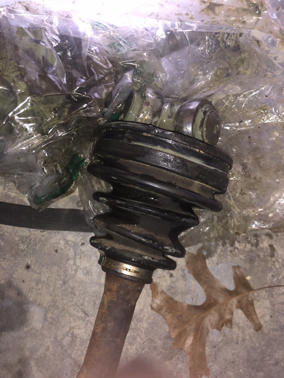

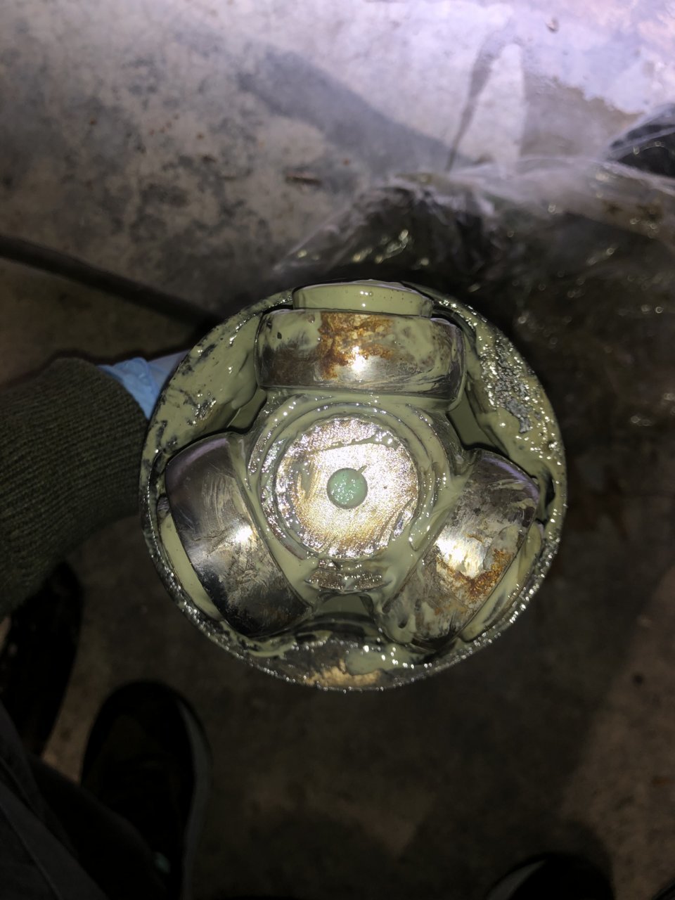

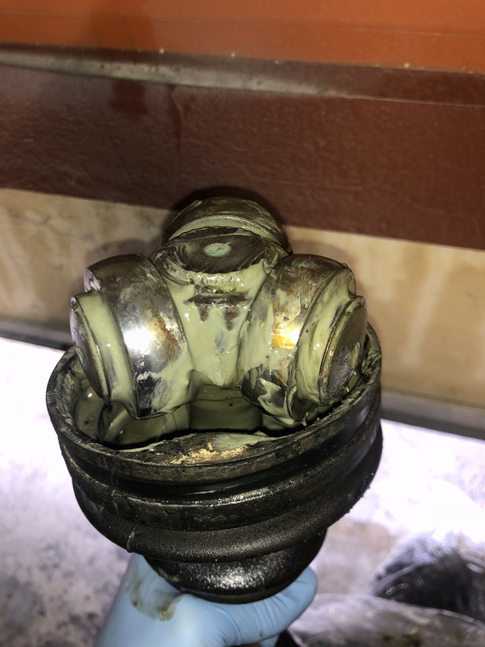

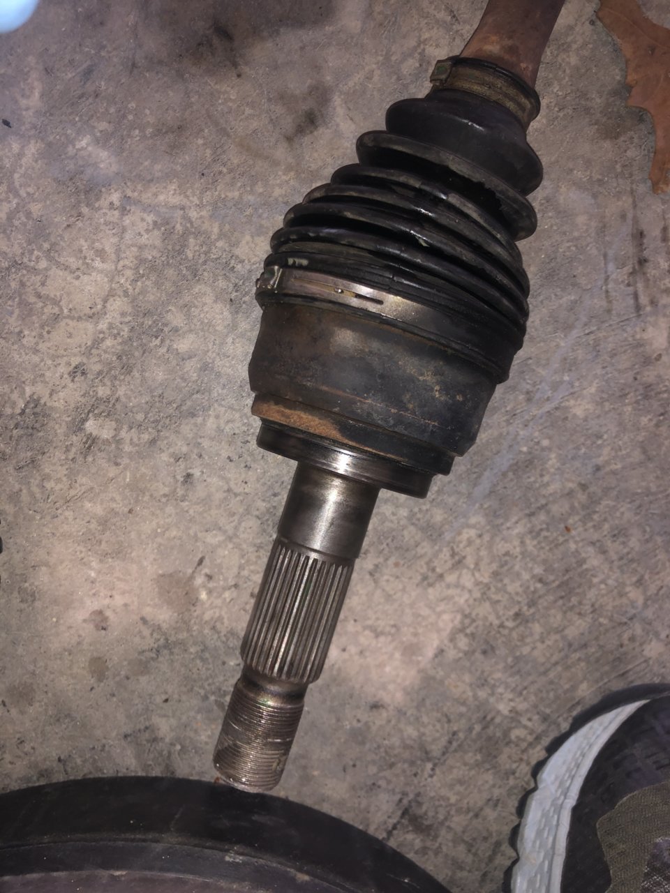

    Surely these are just parts store replacements, but I honestly wouldn't know the difference without asking.

    yeah those look like parts store axles to me

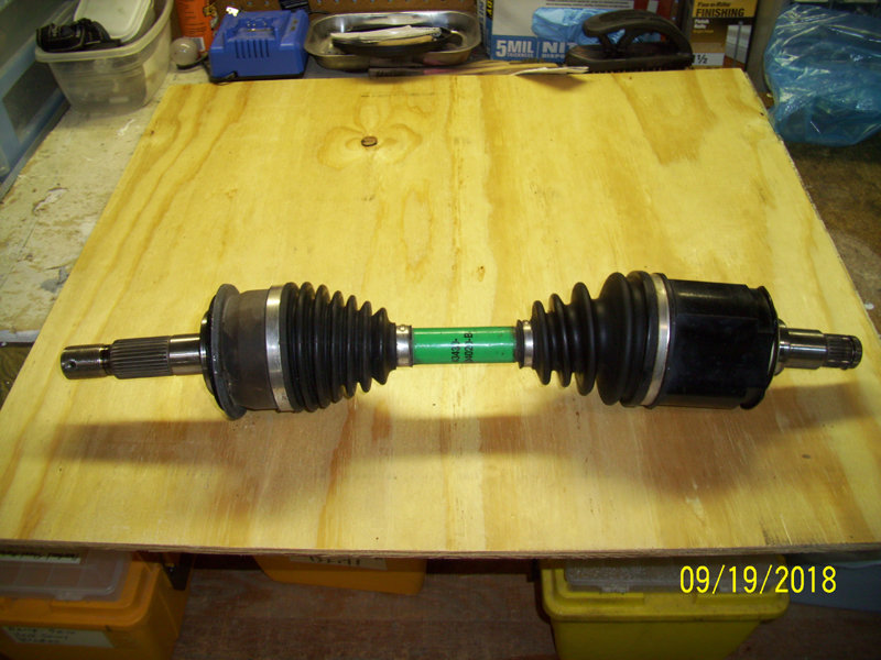

    Photo of my original 1998 4WD front axle:
