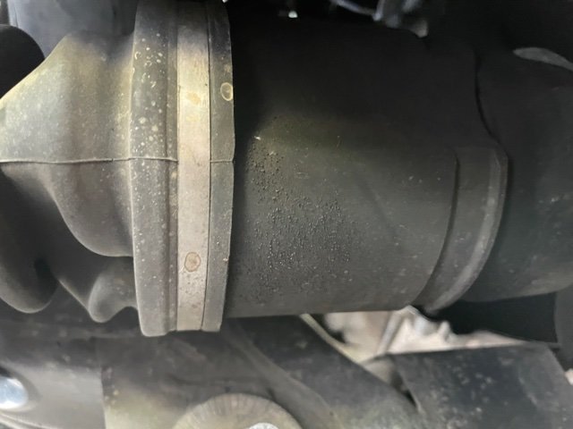

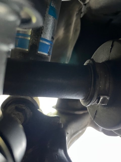

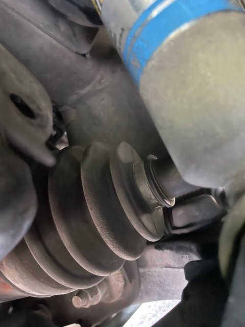

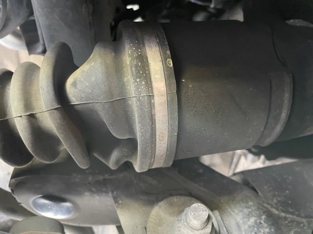

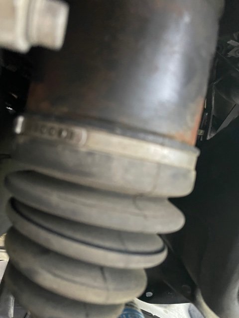

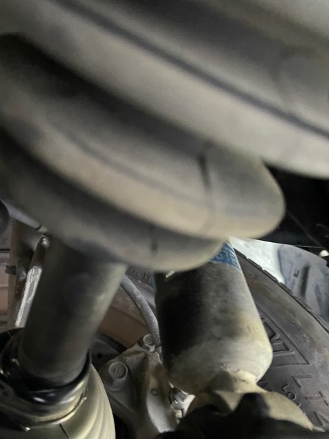

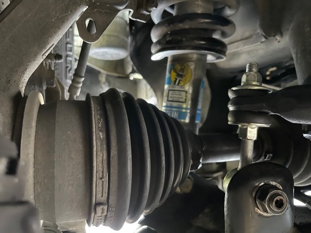

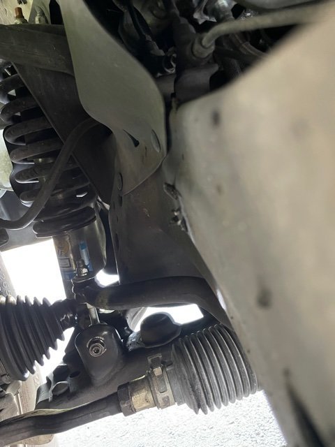

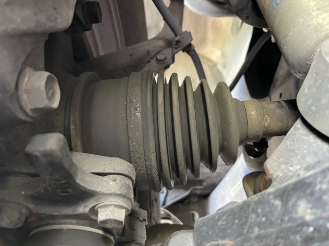

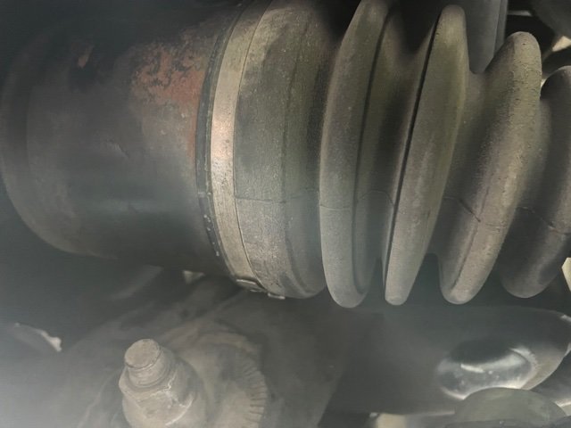

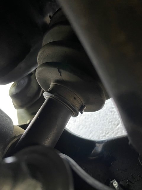

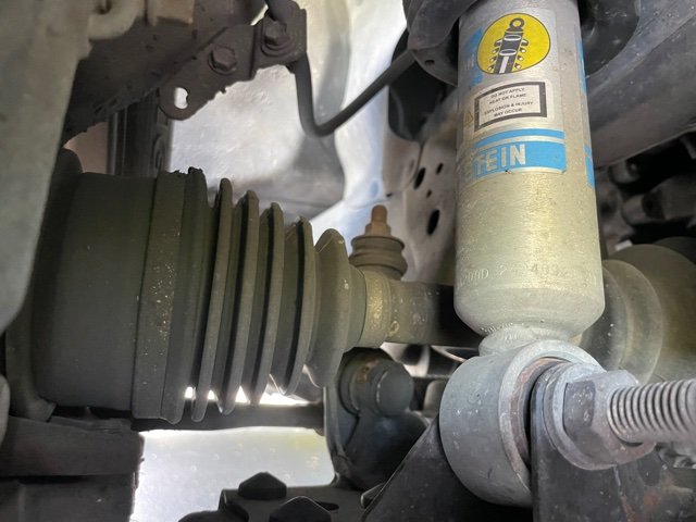

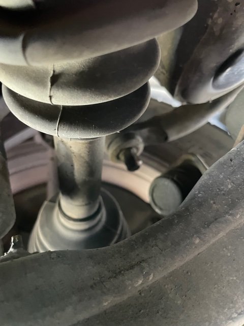

    Similar to the original post, I'm trying to discern whether the CV axles on my 2000 Tacoma (4X4 with A.D.D.) are OEM or aftermarket. Truck has been mine for a while but not sure whether prior owner replaced them. Reason I'm curious is if they are OEM I'll just reboot but if they are aftermarket I'll replace with OEM or the CVJ remanufactured ones (which are only $50 or so cheaper than OEM new if you factor in the core cost). It's difficult to discern but I understand there are some hallmarks of the OEM axles, including (i) green sticker/label on the axle itself and (ii) the fluted contours of the differential-side piece that serves as the female housing for the tri-pod head.
    I have no green stickers nor remnants of green stickers and the part numbers on the boots and clamps look aftermarket, though of course the stickers can just wear off and the boots and clamps could be aftermarket even if the axle is OEM.
    Any thoughts on whether these are OEM or aftermarket CV axles? Grateful for any insights.
