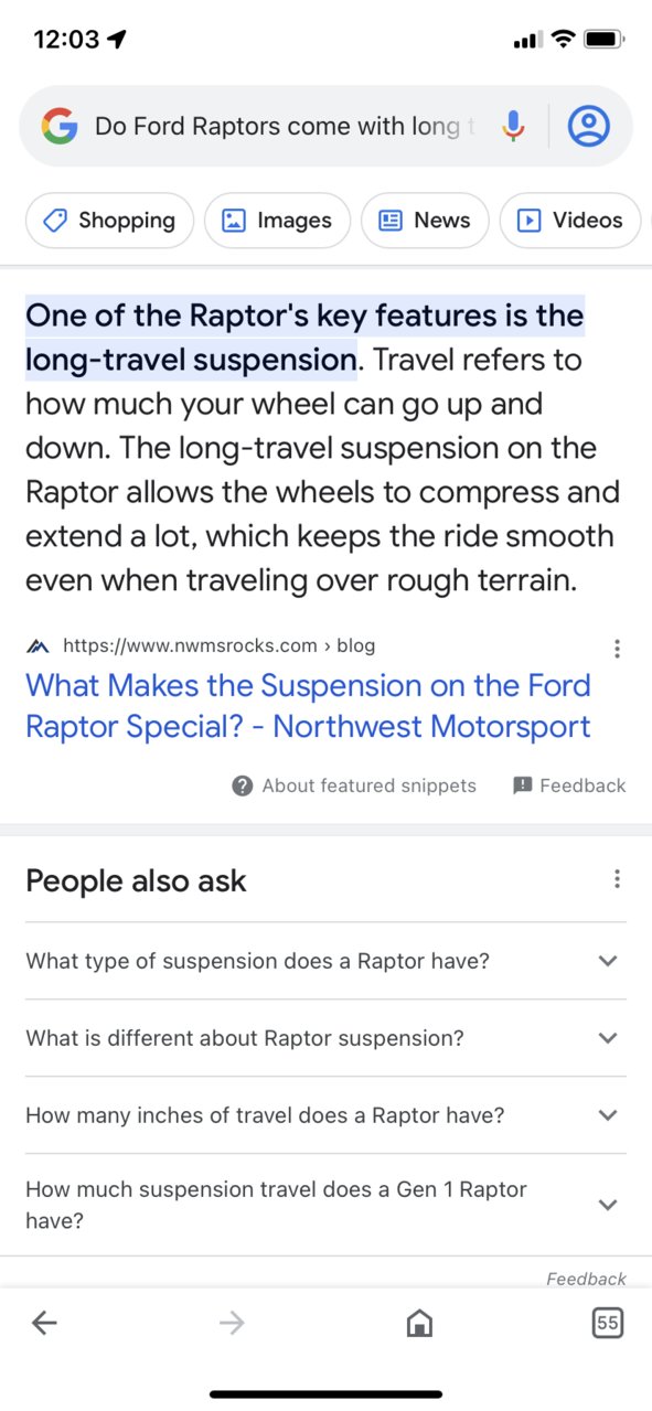

    I thought Raptors came stock with a long travel suspension setup.
    If so. That’s your answer right there.

    No, they don’t have long travel suspension from the factory.

    Raptor has what would be considered a Mid-Travel setup.
    More travel than a traditional F150, but what makes them work is the shock size and valving Fox and Ford developed together.
    And for reference, I’ve owned and built everything from one-off Toyota long travel trucks and a Raptor.
    Raptor does it all with considerable grace, but couldn’t handle the chop or hits a purpose built long travel truck can.
    Never driven any of the Accutine bolt on stuff, but I believe folks like JD Fab have a mid travel kit that can still run stock fenders (with the right wheels), and fox or king shocks can be sprung and valved to ride as soft or stiff as you want.

    Long travel can be used to describe anything over stock spec and they base all of their specs against an f150. Up until this latest generation raptors came with a mid travel at best. A buddy of mine did a raptor conversion on his f150 and it’s definitely not long travel in the sense we all imagine. A 10” travel rear shock on a Tacoma is considered long travel. You have to distinguish between commercial sales terminology and their shiesty loop holes and loose definitions, and what the actual off road industry defines.
