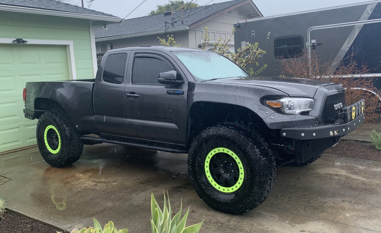

    Please don't even attempt this without spending a shit ton of money and going full long travel.
    I thought I could do the same, and ASSUMED mid travel with custom valved shocks, lots of cool suspension parts, and lots of work would get me there. Unfortunately we can't get past geometry and other matters far beyond our control.
    I've never rode in a long travel Tacoma, but my personal truck with Fox 2.5's, Archive Garage Hammer hangers, Icon RXT leafs, etc does not ride super nice. On some low speed stuff it's pretty cushy, but I have my adjusters set pretty much full soft. This means it rolls a ton through the corners. On the fast bumps, rough fire roads, big pot holes that you hit at a decent speed, it leaves a lot to be desired.

    I have tens of thousands into my truck. I’m pretty sure a bone stock raptor could out perform my truck in every aspect. :rain:

    If it makes you feel any better my truck is full long travel and does great off road and but suuuuucks on road. Everyone that rides in it comments on how stiff it is. It’s valved super light as well.
