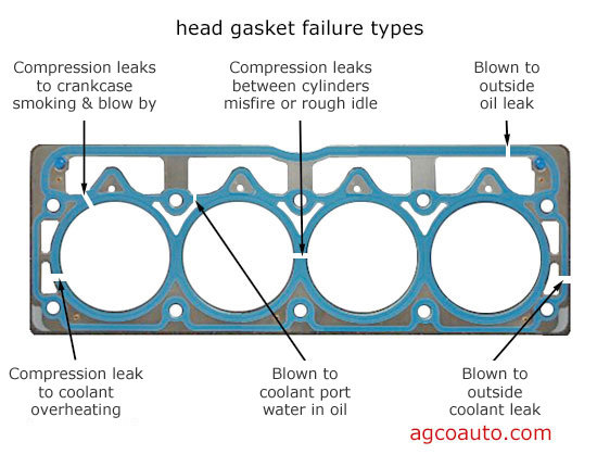

    From what I researched on head gasket leaks, there is a couple of different types and symptoms.
    Blown Head Gasket Symptoms:
    • Coolant leaking externally from bellow the exhaust manifold
    • White smoke from the exhaust pipe
    • Overheating engine
    • Bubbles in the radiator or coolant overflow tank
    • White milky oil
    • Significant loss of coolant with no visible leaks
