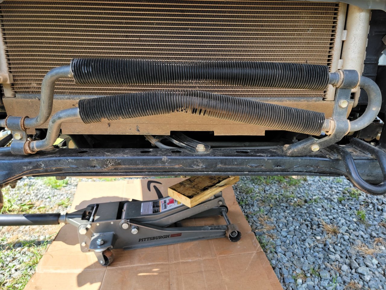

    So I'm getting ready to install an aftermarket bumper tomorrow and came across this during disassembly.
    Obviously I hit it during some off-road expedition, but I don't see any leeks or experienced any signs of overheating. Should I leave or fix it?

    Looks OK from here aside from being bent. I'd leave it. Some bumper/winch combos require you to bend that back some.

    That's the power steering fluid cooler. I agree that it's probably fine so long as it isn't leaking or pinched so much that flow is constricted.

    My vote is to leave it alone.

    Glad to get reinforcement on my original opinion. If it ain't (operationally) broke, don't fix it.
    Guess I'll leave it be. Thanks for help!

    Bent but not broken; let her ride man!
    PS: and I would not try to correct the bend either; that's when it will snap! :)
