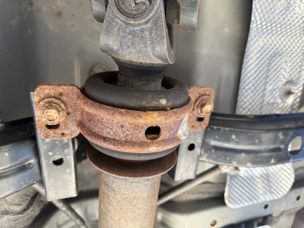

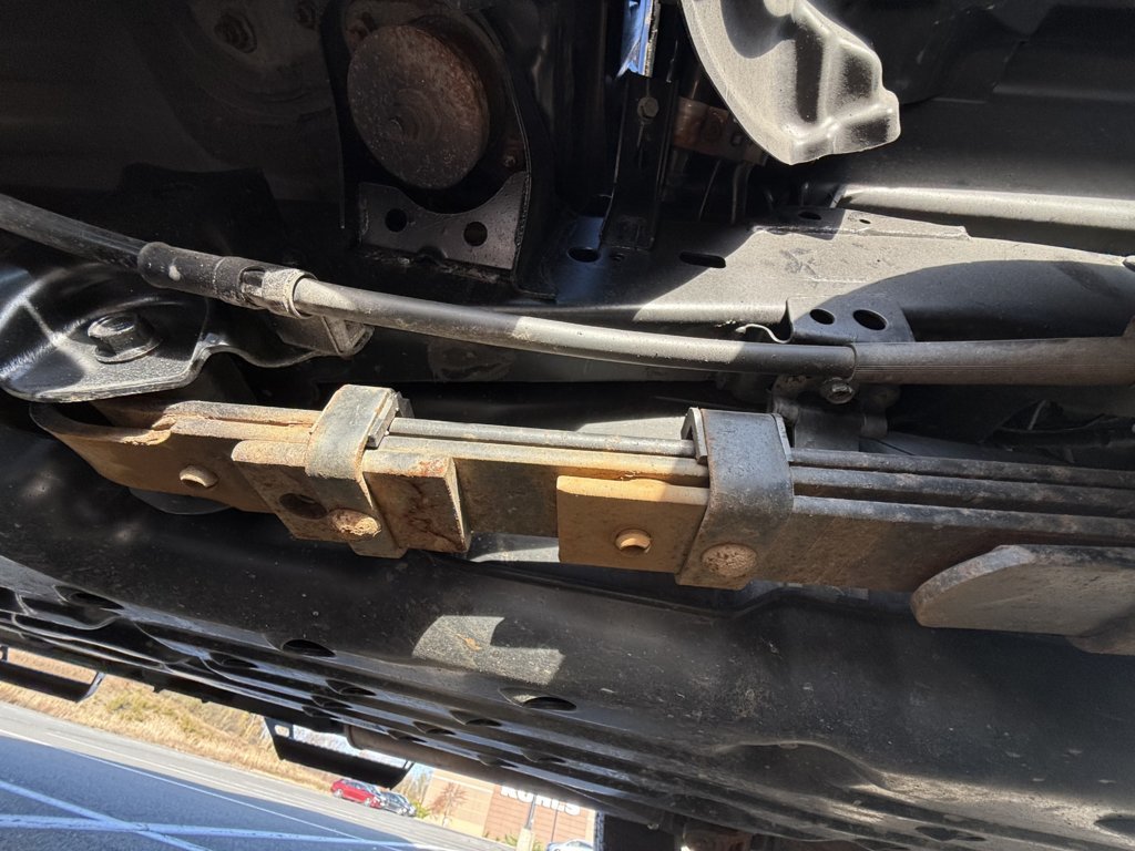

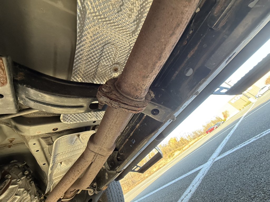

    Recently picked up this 2021 Tacoma OR MT with 25k miles on it. Noticed this rust underneath today. How can it be mitigated/ how concerned should I be?

    Nothing is on a critical part.
    The CB bracket seems a bit much for as young as it is, but again, those are not important bits. Everything else looks normal.
    If I were to buy it, I'd give it a thorough cleaning and coating and then not worry about it.

    CB bearing holder and leaf spring are just surface rust. clean and spray some rust paint wouldn't hurt but I doubt it matters much. Both replaceable when time comes.
    My exhaust looks like that an exhaust shop said as long as it doesn't leak don't touch it an nothing will happen. But at some point the whole sections need replaced but nothing to worry about as others have stated.
