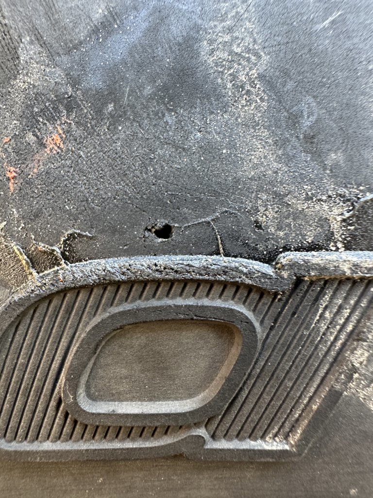

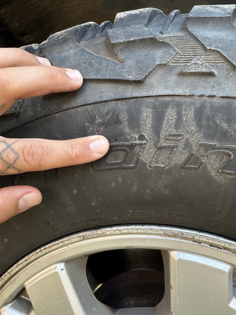

    Hi guys, long time lurker, first time poster... 2013 Tacoma with BFG KM3s that are 5.5 years old with like 15-20% tread life.
    Some tweaker tried to slash my tires in LA where I live (not the first time it's happened to people in our building), and he mostly failed, but he did put a tiny pinhole in the sidewall of the front driver's side tire. It leaks at the rate of a fully flat tire every ~72 hours.
    How dangerous is it to drive on the highway with this? I've read that sidewall punctures can cause blowouts. My tire shop won't repair it.
    These tires are at the end of their life (42,000 miles), they're badly cupped, and need to be replaced anyway. But I don't have $1k lying around at the moment, and would otherwise put off replacing them until they're truly done (I have a 2nd car for daily driving). I am supposed to go to a campout this weekend (2-3 hours away). I am wondering if I can squeeze one more trip out of them, or would I risk a blowout on the interstate? I typically load 1-2 dirtbikes in the back so a blowout could be especially bad.
    My instinct is that the hole is so small it will be fine, and I can just keep pumping them up indefinitely until I am ready to pull the trigger on 4 new ones. Please tell me if I'm being an idiot.
    Thanks...

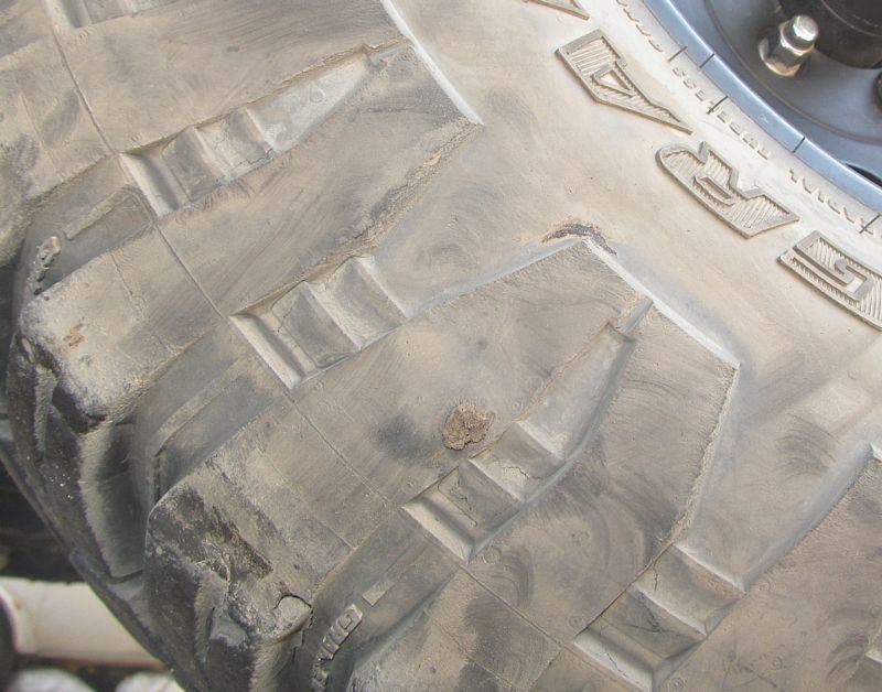

    Twice I've had similar punctures happen (not from scumbags w/knives, but from sticks & bushes while offroad)... Both times I put a plug in it (knowing tire shops wouldn't touch it) and never had a problem, even offroad & aired down. Both times they went over 30K miles too (1st one held until the tread wore out, 2nd one pictured, still going). YMMV.
