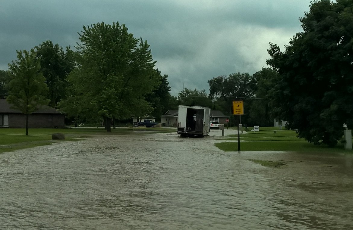

    I live in an area that floods. And I mean... a lot. At least once or twice a year a creek next to my neighborhood fills up and literally the entire subdivision is under water. In fact, when it gets really bad, most of the town floods. And it happens REALLY fast due to other streams flowing into it. How high can standing water be where the Tacoma can drive through it without damage?
    This is a pic of us leaving the subdivision just when it started to fill up. At some point there was no visible grass and the water was in the garages.

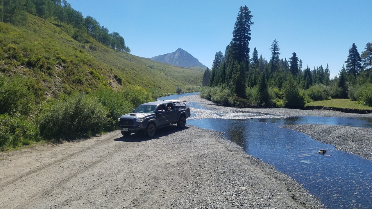

    Alternatively, I spent 15 minutes walking this crossing and shuffling my feet across the gravel to try to guess how much I was going to dig in. The fiancee was on the hiking bridge waiting to take a super kewl social media video of the crossing. She got impatient, started chasing butterflies, and I got this photo instead. Eh, no regrets. :cookiemonster:
