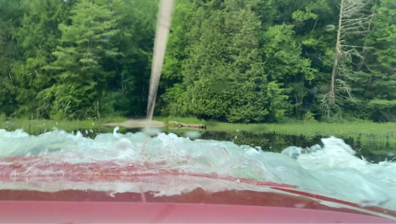

    This was barely safe,,, got away with ,but I try not do it again.

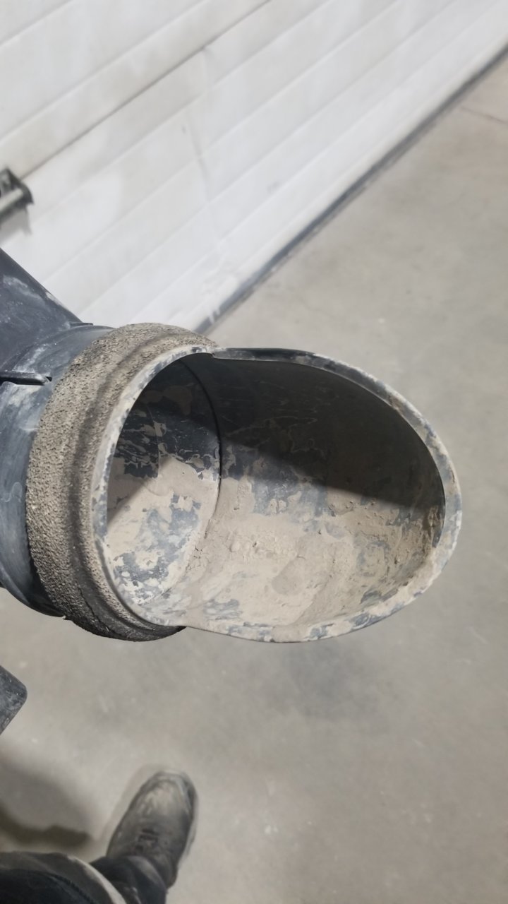

    I would like to take the second to point out a snorkel has an entirely separate use from just keeping water out of the intake. But the always over looked factor is dust. My air filter lasts far longer with the snorkel or raised air intake. It is also cheap insurance from water ingestion when things go south. Lessons learned from my second gen.
    I don't do any excessively deep crossings and yet my intake looked like that.

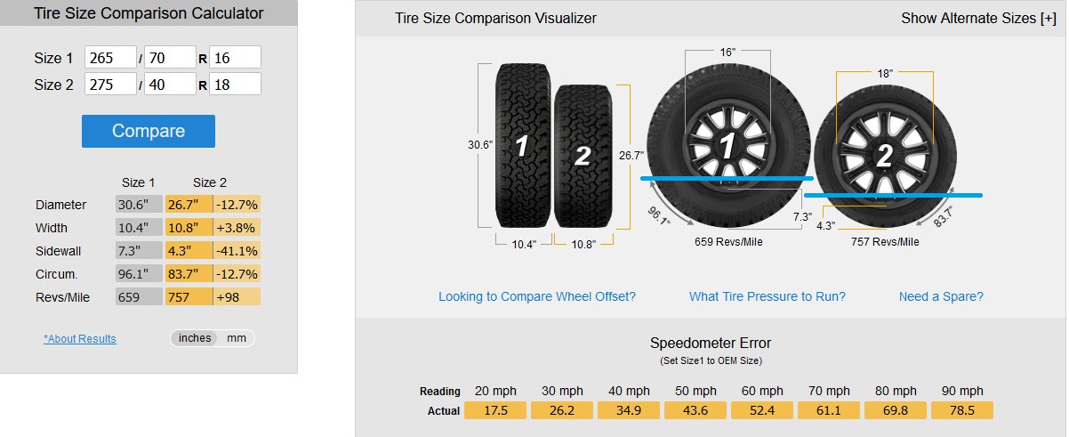

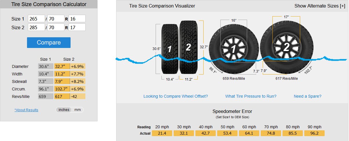

    TRD Offroad or Not - This is my ROE for water. In ANY Vehicle!
    I add on about 1" to get me to the top deepest part of the bottom of the metal wheel. So if the tire is 7.3" to 7.9" tall at the bottom, I would do about 8" to 9" of water.
    This ensures I don't:
    1. Dunk hot brakes
    2. Dunk CV Boots that may leak
    3. Dunk an oil pan or transmission pan
    4. Dunk an alternator
    5. Dunk a differential (front or rear) that may have a cracked breather tube
    6. Suck water into an intake
    7. Suck water into an AC drain line (have seen that before or wouldn't believe it)
    8. Submerge an ECU / PCU
    9. Leak water in bottom grommets that soak the carpet pad.
    10. Bog the engine fan (electric or mech) with the added resistance of water.
    Can you go deeper and survive? Sure. Lots of people do. How much of that is luck? An increasing amount with each inch of depth you ford above the minimum height of the inside of your wheel.
    Following this guideline means that almost 100% of the truck that is below the water is easily replaceable because it is your consumable tires and maybe a wheel, but that's pretty impervious to water.
    For comparison, here is my truck tires compared to the wife's sports car tires. Again, same ROE. I'm not going deeper than about 4" to 5" in her car.
