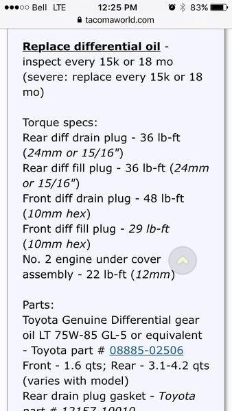

    Drain and check plugs are bigger than my 21 mm. Buddy had a 15/16 which was close. Going to the parts store now.
    Sorry guys, new to this what gear oil am I after as well?

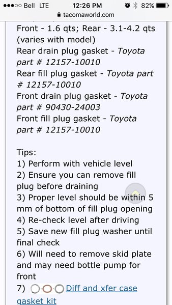

    Rear drain plug gasket and rear fill plug gasket need to be replaced as well when I'm doing an oil change? Looks like it just trying to confirm.

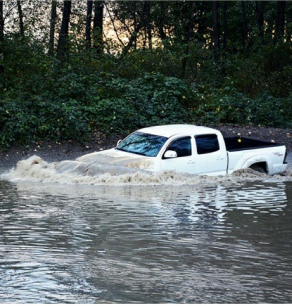

    Going to get my sister during a flood; found out that the rear end of these trucks will float when deep enough = over the hood and hitting the windshield

    Was this an emergency situation or were you just having fun?

    I did that depth in my Tacoma Prerunner during an unexpected Ft. Worth flood. Handled it just fine.

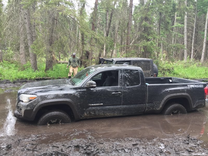

    Annual Off-Road event
