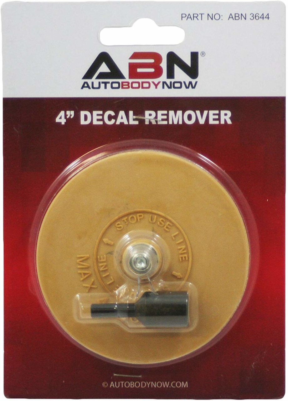

    Agree with those who recommended the eraser wheel. I have used numerous times to remove adhesive when debadging over the years with great success. It takes a lot of labor out of the process.Then finish the area with polishing compound.
    757yotas[OP] likes this.
