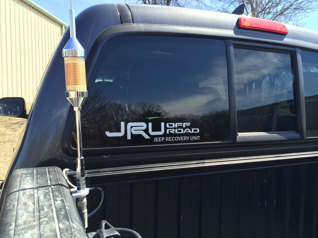

    I mounted mine to the end of the bed rail nearest the tailgate. Don't have a better picture at the moment, I can post more helpful shots tomorrow if you want. I used this http://www.amazon.com/FireStik-MK-2...-Mini-Kit/dp/B000X39TQ0?ie=UTF8&psc=1&redirec and some spare metal lying around to get it to attach onto the bed rail. Don't know how well it'll hold long term, but I've had no issues. The only downside is you have to watch the antenna (I have a 3 foot firestik) when you on the trail going under trees. I preferred near the back as it gave me the least amount of interference from the cabin. I didn't intend on mounting it this way, but it required the least amount of modification to the vehicle. I ran the coax inside the frame up through the drain plug underneath the right front passenger seat. It's gotten snagged a few times, but no issues. I have a radio quite similar to yours and sits comfortably in the center console.

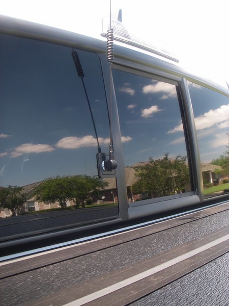

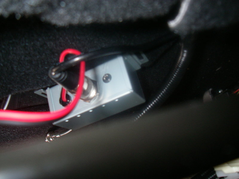

    I have the same radio and opted for a stealth no drilling install. I also have a Tonneau cover so my options on bed mount antenna were limited.

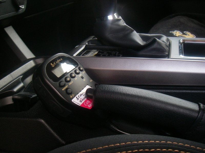

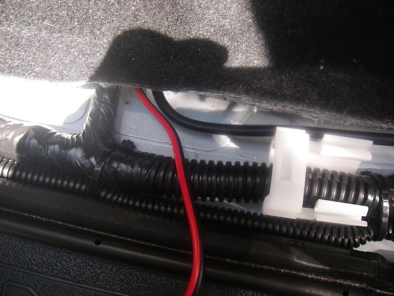

    Power box is under seat pinned by the seat base spring. power box under seat.jpg

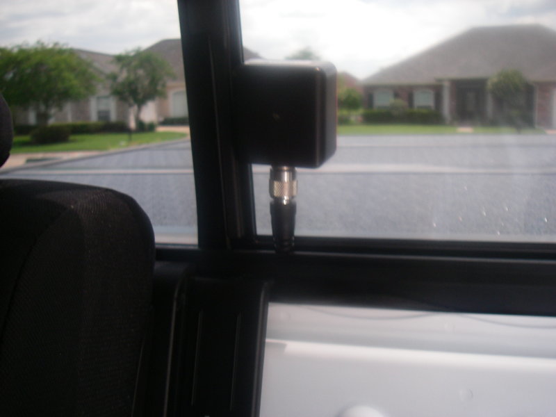

    Antenna receiver mounts to glass and cable runs inside door panels to power box under seat inside Glass mount.jpg

    hows he signal with that glass mounted antenna?

    Reception on a glass mount is as good as any, and I've had all types over the years, as long as you install it properly.
    Mainly, the area where it makes contact with glass needs to be free of any metallic based tint, and the antenna need to have locktight on the treads to stay and not fall off.
    Where you loose over a conventional 4ft antenna is that you're limited to a 50 watt output, which is illegal if that makes a difference. The max peak output on my CB is 8-10 watts so I'm ok with it.

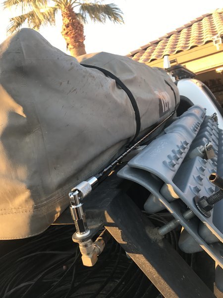

    I had to put a collapsible elbow on this so that I don't destroy the ceiling lights (again) in the garages I frequent :)
