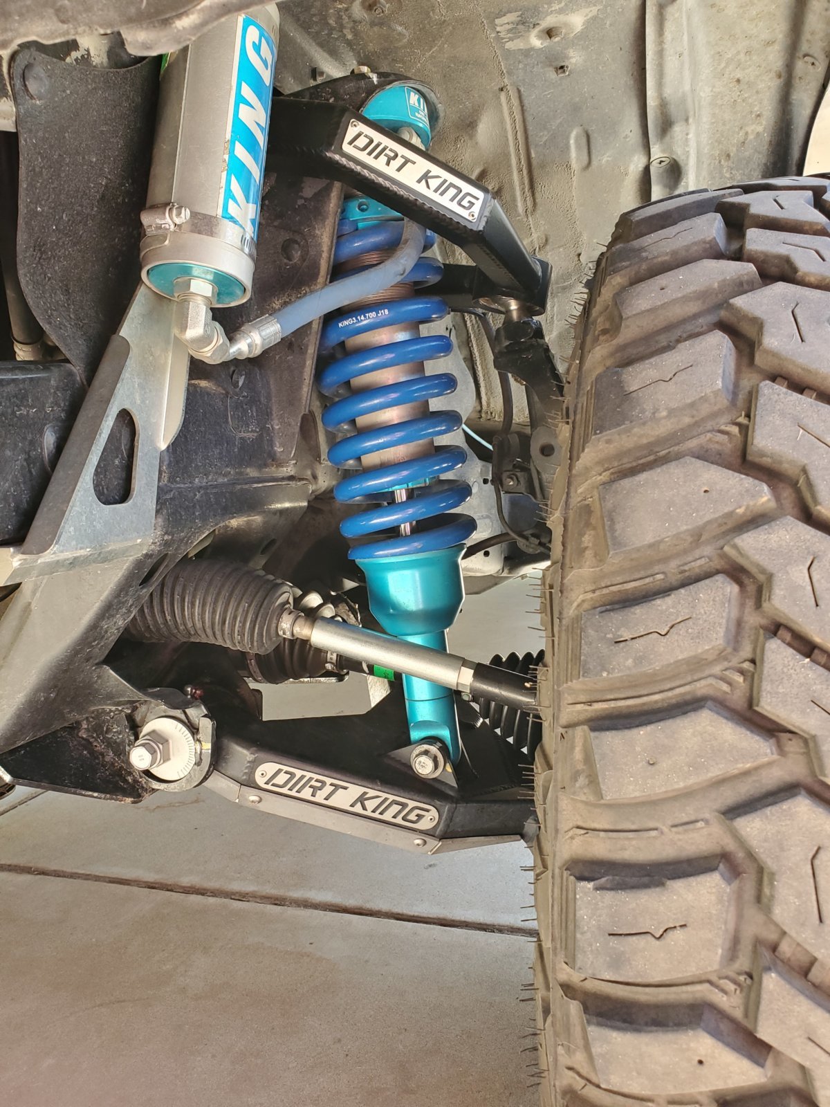

    These trucks are real easy to work on.
    I did this in 2 days, including new wheel bearings. Good luck with your truck.

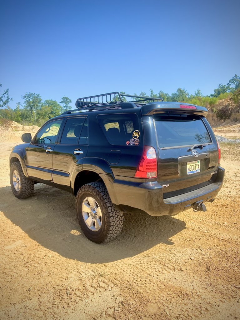

    buy a shit box and not have to worry :rofl:
    I recently bought a 2008 4Runner sr5 4x4. Took me about a month but found one for $6k it just needed a little love. It’s actually not a shit box. Now I don’t have to worry if I break my truck.
