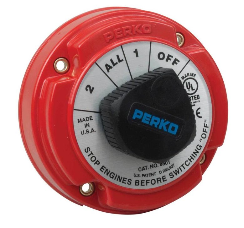

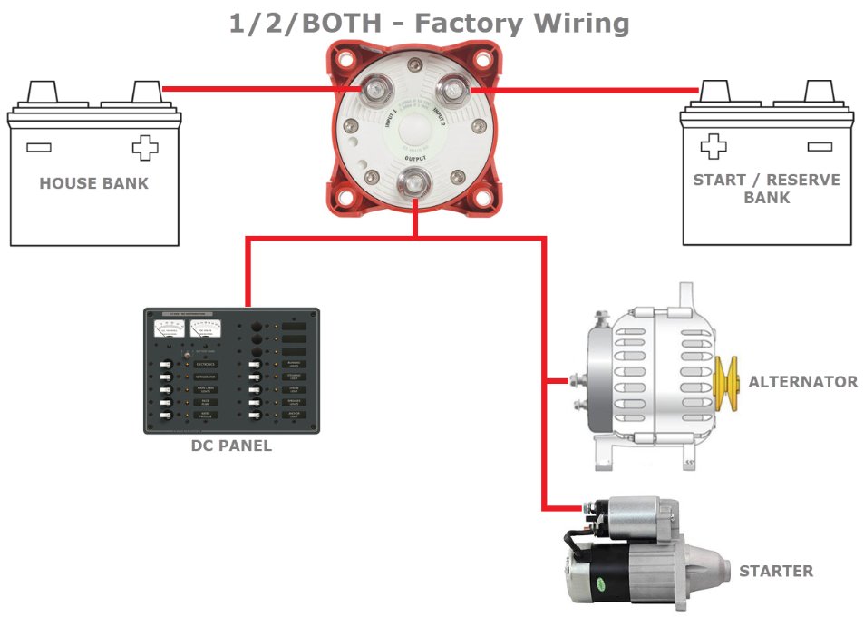

    Depending if you're wanting to add more voltage or amps to a system, you can connect batteries together in series or in parallel. Parallel will add more "capacity" (amps) and keep voltage the same. Series will add more voltage to the system.
    But I'm assuming you mean how are they actually being connected? Usually with a selector switch. So then you can draw power from Battery "1", Battery "2" or Both (or kill power to circuit completely "Off").
    Usually one battery would be your starting battery, usually one is your accessory battery (deep cycle).
