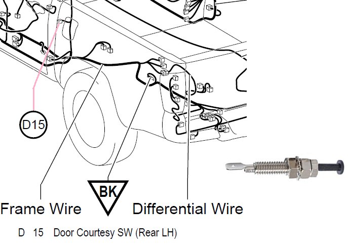

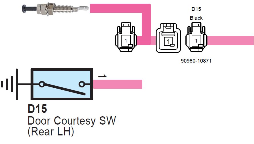

    Switch pin to tailgate, parallel with door courtesy switch. Loom the wire, run it alongside the frame wire to tailgate. Keep Cargo Lamp Switch on "DOOR".

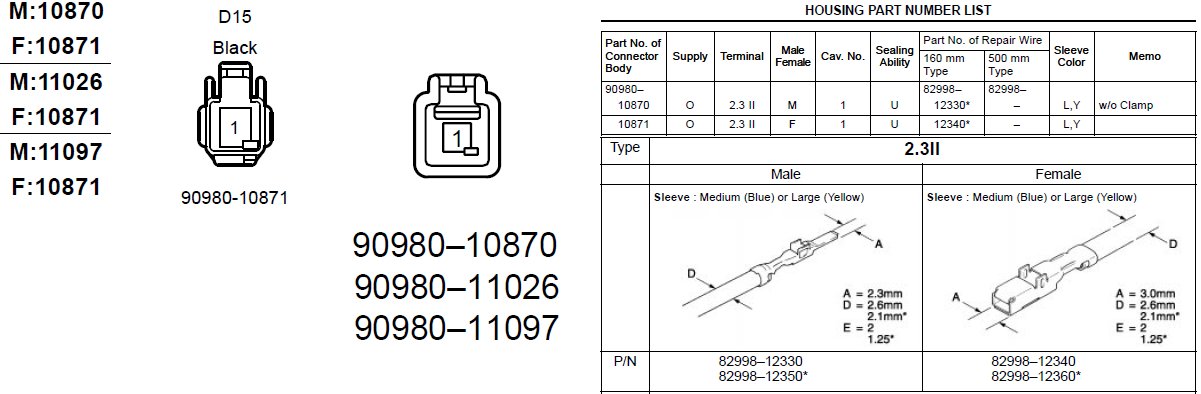

    Male & female connector to place inline to courtesy switch so you don't fudge the wire tap and can return to OEM.

    Run a separate wiring harness from the battery (or from an aux fuse block if you have one), use a 4 pin relay and a stand alone switch.
    Determine which wire turns on the lights from the harness and tap into that one. You can use any kind of switch you want from there. A button switch, toggle, latching, etc. This way, the switch will only run the bed lights and not the lights in the cab.
