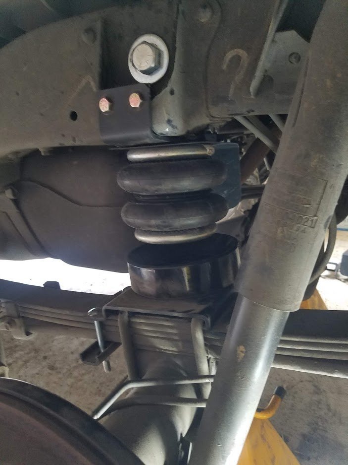

    Airbags are the shiz. Firestone pictured

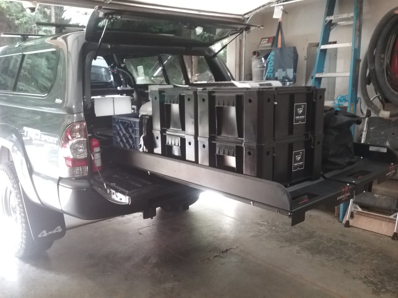

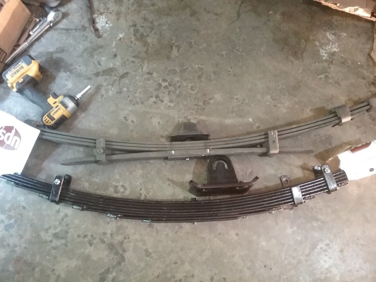

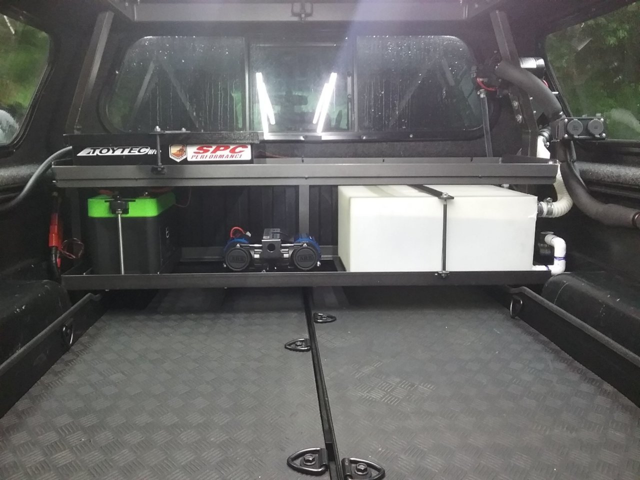

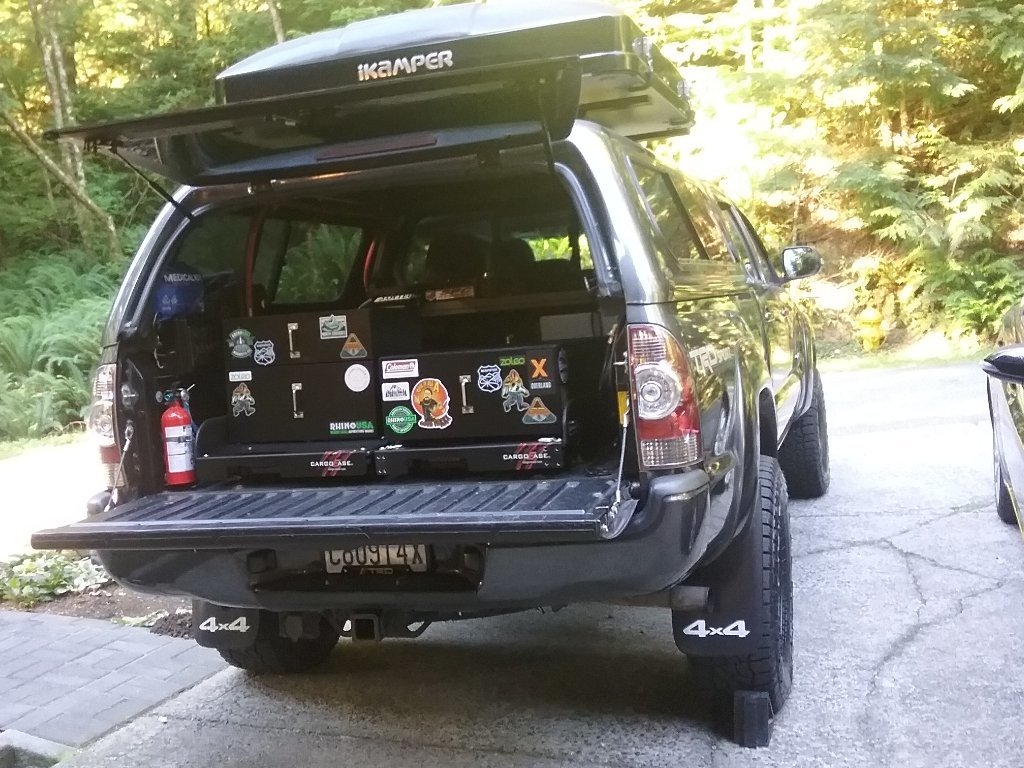

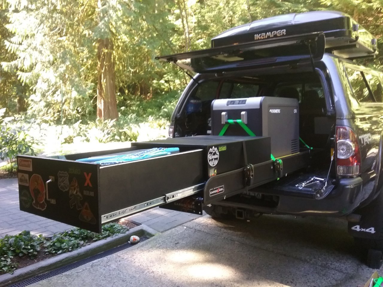

    Natrex, something to consider is how you will intend on using the truck.
    Will the weight stay in the rig.
    Will it come out.
    In my build I tracked everythings weight to a fair degree. What stays in and what comes out.
    Lew at Alcan Springs made my rear Springs
    to accommodate the weight and ride and in my case a two inch lift. I didn't want Deaver for example and be sky-high out back, forcing me to raise the front.
    Understand how your going to use the truck, understand your weight.
    Sometimes you have to buy once and cry once.
    Thanks to Lew at Alcan Springs, I carry 900# on trails. It rides beautifully. With gear out the ride is equally nice.
    Make it nice or do it twice.
    And guys... sorry for duplicate ..pics.
