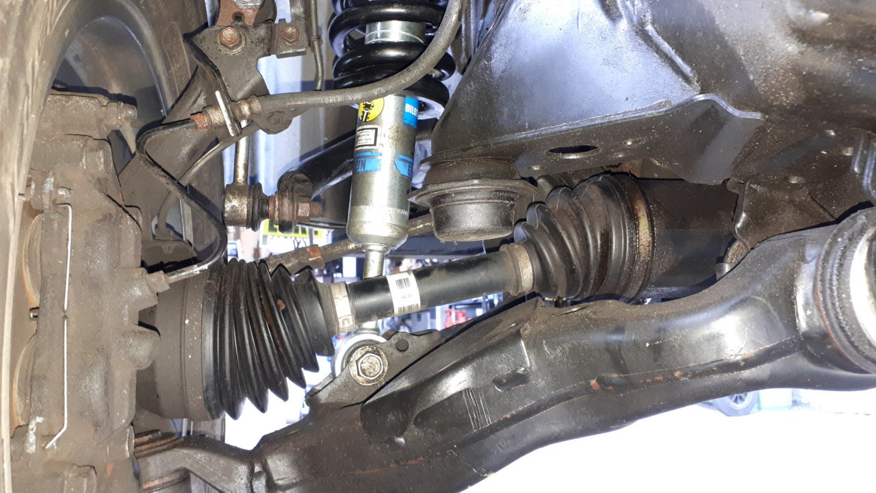

    Hmm if thats the case I might just give 4wheel parts a try for the alignment.
    Im going out right now to get rid of the 1/2" spacer. Fingers crossed. Maybe this time ill loosen the upper and lower control arms then re torque once on the ground. I torqued upper while on stands and lower once on the ground yesterday. Who knows

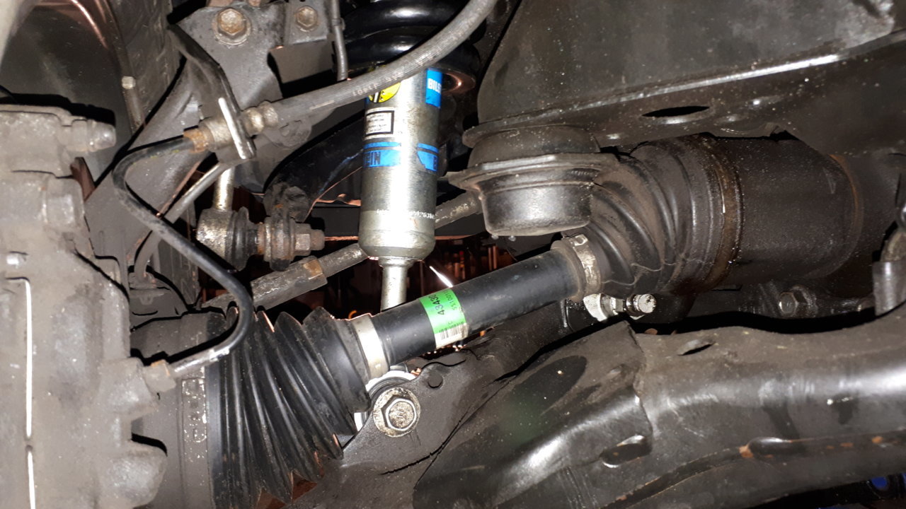

    2016 Grey Tacoma sport dc long bed
    I only have one 1/4 spacer..
    *UPDATE.
    I threw on a dif drop just for piece of mind and it looks like it made a tiny difference. Still not perfect but heres the driver side now to compare. Probably all in my head..Hoping it gets better once the rear ends done

    yeah that's still pretty bad. Gonna have to ditch the spacers IMO.
    A 'diff drop' should be more accurately called a diff 'tilt'...they don't do a whole lot, all they really do is tilt the front of the diff forward a half inch or so. It does help angles a tiny bit but usually in cases like this, people put them on thinking they'll solve the problem when in reality they hardly do anything.
    If you're tempted to increase the size of the diff drop (tilt), don't...you don't want to tilt it too far forward and compromise the gear oil's ability to circulate they way it was intended to. Also you could run into issues with it being too low and hitting your skid plate.
    My CV angles on my 04 looked similar but not quite as bad when I first put my Kings on and preloaded them to 3" of lift...I thought I could get away with it but after a few months I blew out a CV boot. Lowered the preload a bit and corrected the angles but the damage was already done...I ended up blowing an entire CV not long after that on an easy trail. Get them fixed soon if you can.
