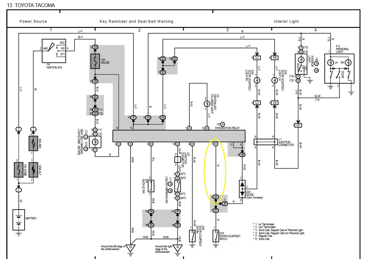

    Cutting the red wire circled below should be sufficient to mute the key reminder and retain full function of the dome light. I have not done this myself. I may do so along with the seat belt reminder.

    no cut the blue wire! You’re going to blow us up. LOL

    Why are you posting a 1st Gen diagram?

    Because the Toyota system will last many years while jeep system will have many reliability issues...
