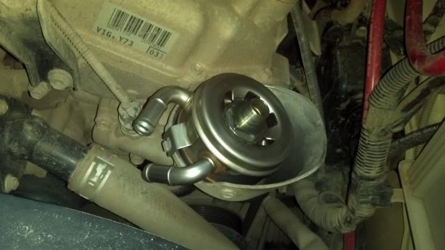

    any chance anybody could take a picture and post it to show me what i am looking for. Thanks for the fast replies.

  7. Nov 3, 2016 at 10:43 AM
    tomwil
    tomwil Well-Known Member
    May 15, 2014
    #129887
    8,025
    East Coast USA
    2014 Reg Cab 4x4
    IronPeak likes this.

    that was fast thanks.

    Thanks for the help guys. Just went out to the truck and i do indeed have the tow package.

    Didn't realize that was an oil cooler!

    It's NOT. It is what connects the lines from the oil cooler to the engine.
    Also, trans cooler is only on automatic, and tow package comes with a 27F (larger) battery.
