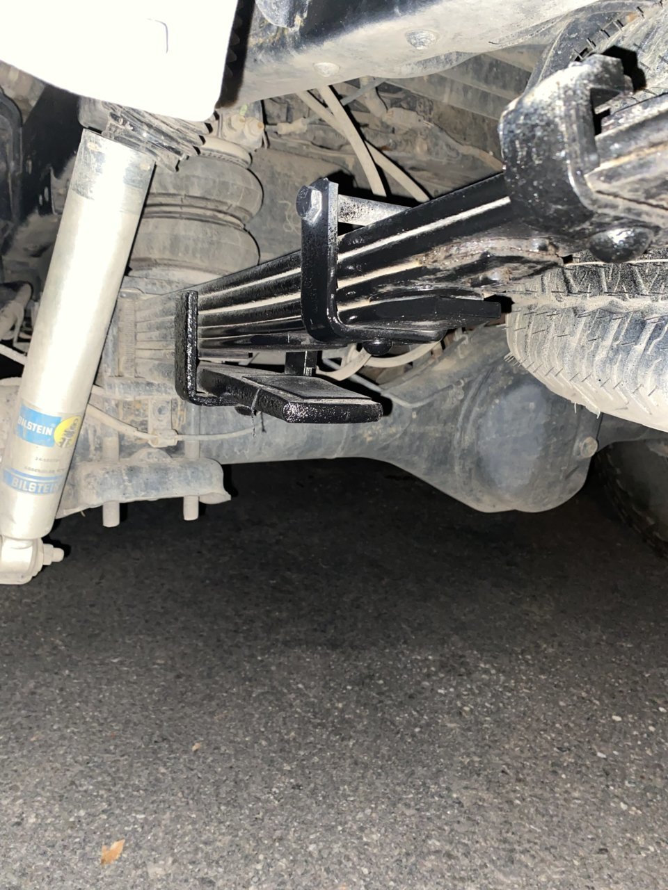

    How do I fix tacoma Lean?? I have a 2013 Tacoma on Bilstein 5100 w/ OME 2" 885 coils and Icon AAL. It's more obvious in the rear than the front. How do I fix this? Should I get new leaf springs?

    Front spacers yes.
    Leaf spacers is 1:1 and he's referring to the gas tank lean.
    A 2013 is likely sagging, the springs are probably flat and the AAL is likely not doing anything anymore.
    OP take a picture of the leaf springs above the axle.

    Using a spacer on a sagging spring is a waste, you'll likely need u bolts, the amount of work involved just put new springs in.

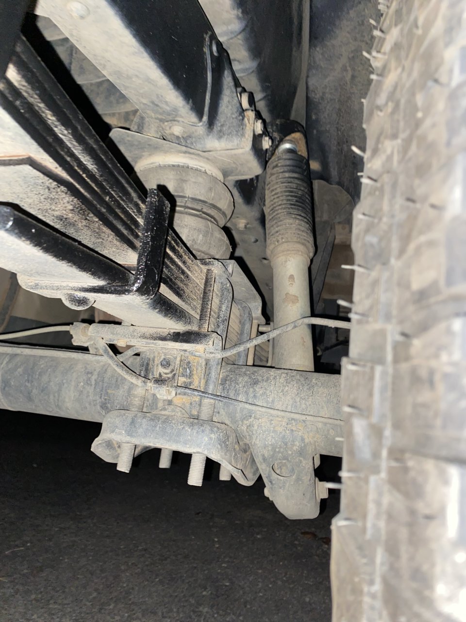

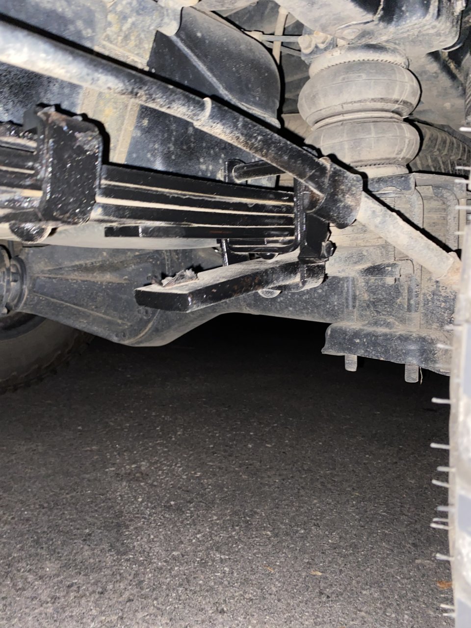

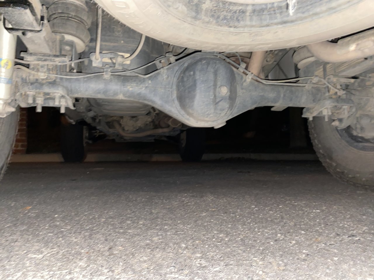

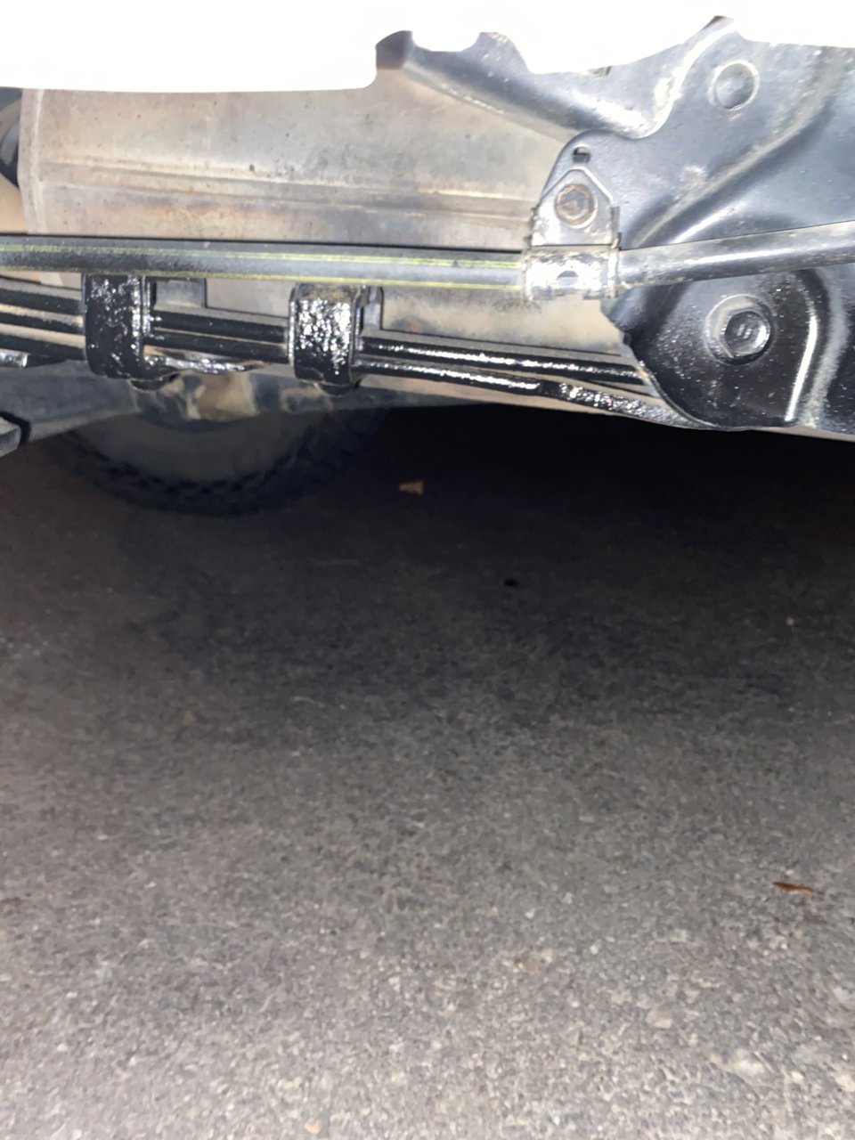

    Just added some photos

    Dude just bump the air bags up haha.
    Your left pack looks flat but its hard to tell.
    How much psi do you run? 5 unloaded?
