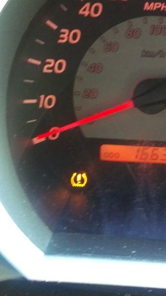

How do i fix this???

    Its been on for awhile.

    Add air to the rubber things that touch the ground.

    That's the thing. The tires have the correct pressure.

    Than you probably have a faulty sensor.

    Did you check to ensure your spare has the right pressure too?

    There is a reset button under the steering wheel.

    I'll check that, thank you. I didn't know if had a sensor.

    there is a RESET button under the wheel. if doesnt work, should be a bad sensor.
