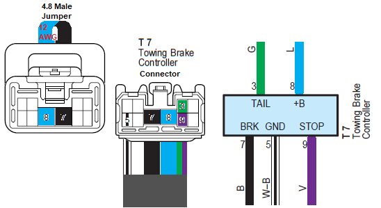

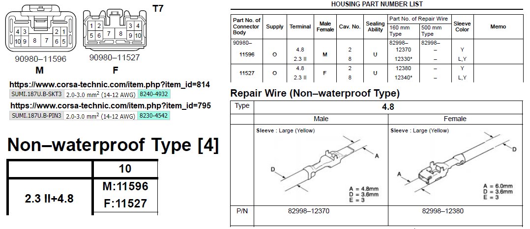

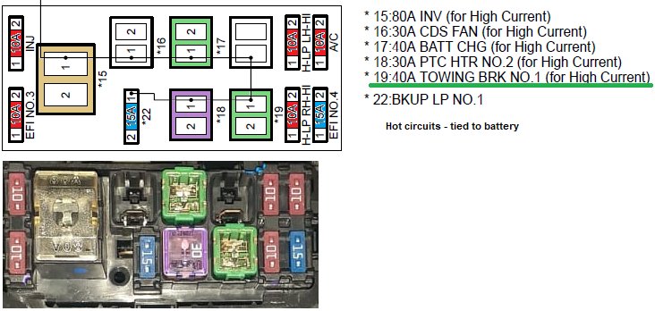

    12 gauge jumper wire on the mating connector to the T7, bridge pin 8 (40A) to pin 7.
    You can lower the amps to a 20A (low profile JCASE fuse) from the 40A in the engine bay fuse/relay box.

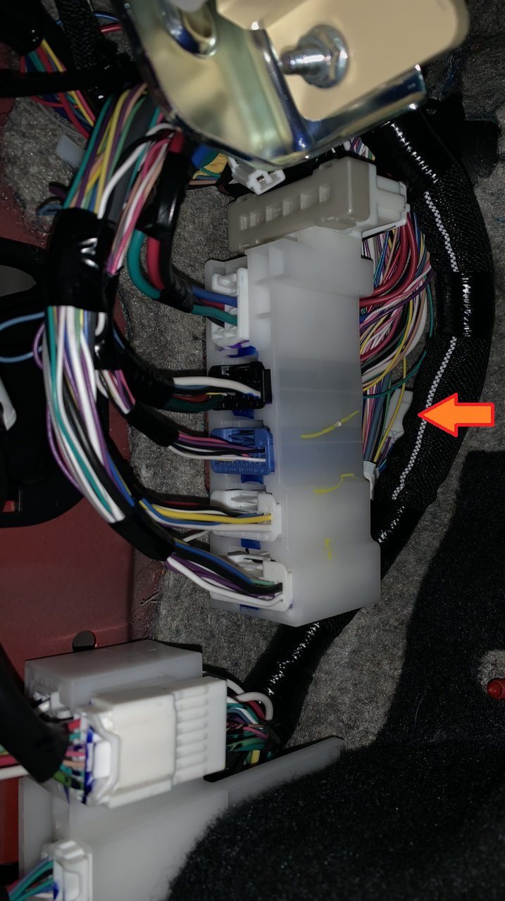

    Cool! This connector is located near the kick panel, correct?

    Is the T7 connector in the area of the interior fuse panel? Lower left of the steering wheel?

    Correct.
