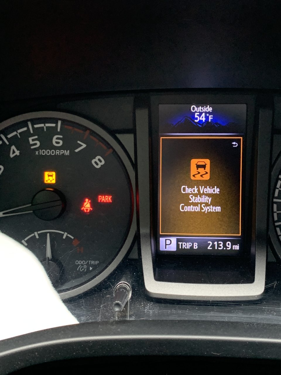

    I got my alignment done since that was the problem but this won’t go away. How do I get rid of it?

    Have you lifted it or anything recently

    Maybe the shop nicked a wire? Otherwise I'd disconnect battery for 10-15min, if that doesn't help it's a dealer visit.

    Check your abs wiring and sensors at all 4 corners. I'd bet something got yanked on the lift install.

    Have you tried turning it off and on again?
    Hook up and obd scanner, might tell you a bit more then the dash.

    Im thinking abs sensors on all 4 as well

    Steering angle sensor could be pissed... if it has one
