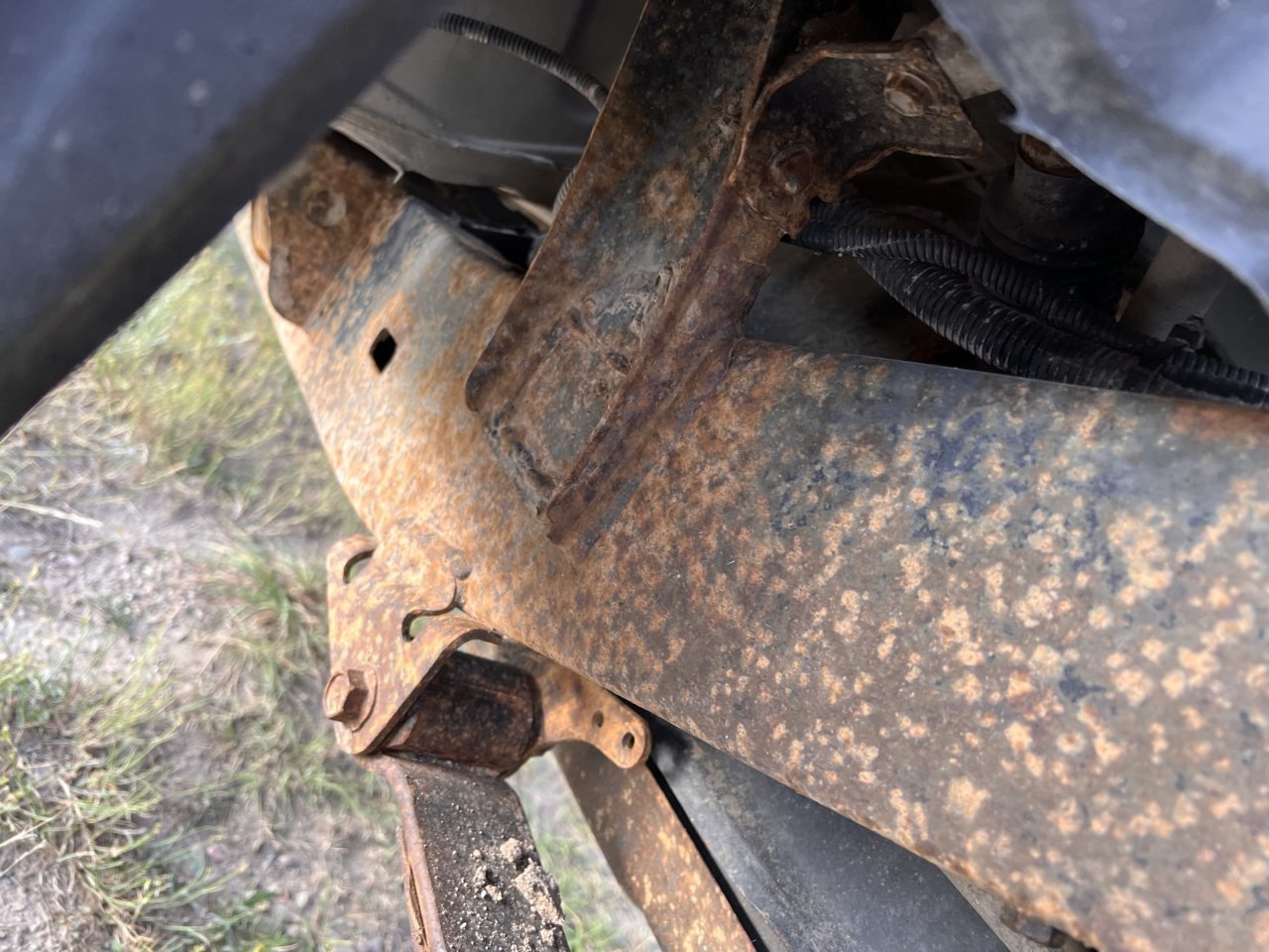

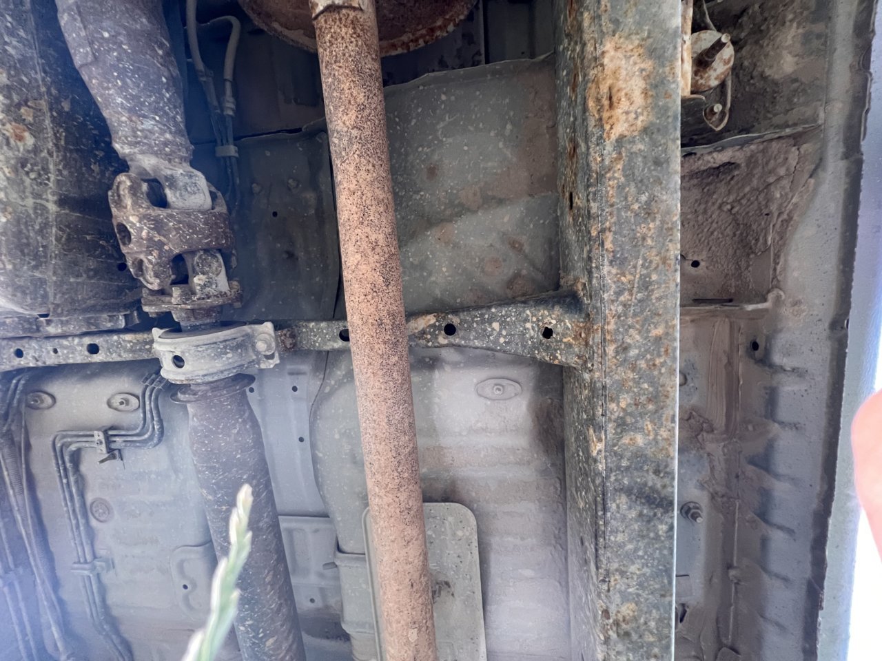

    I have 2000 Tacoma xtracab I recently bought off my dad. There are some minor issues that need repair and I’m not sure if this rust is okay. There is no cracking or corrosion on the frame just what appears to be surface rust. How do I get rid of it and keep it from coming back?IMG_6312.jpg

    Depends just what options you have to use .
    Media blasting of some sort.
    Wire brushing with air or electric tools or by hand.
    Depends where the Truck lives Primer and Paint or something like fluid film .
    Comes down to how much winter chemicals the truck sees.

    For a 23 YO truck very little rust. How many miles? Look like a desert truck.
    How much work and time are you preparing for? Easy route is to spray it with Fluid Film and forget it. Dirty and time consuming is to wire wheel and paint.
