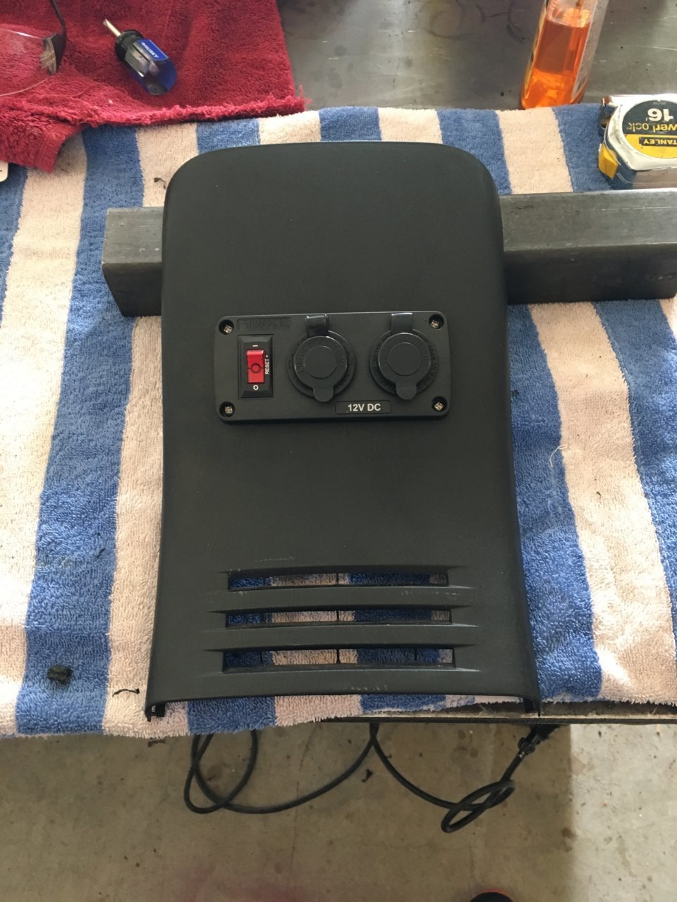

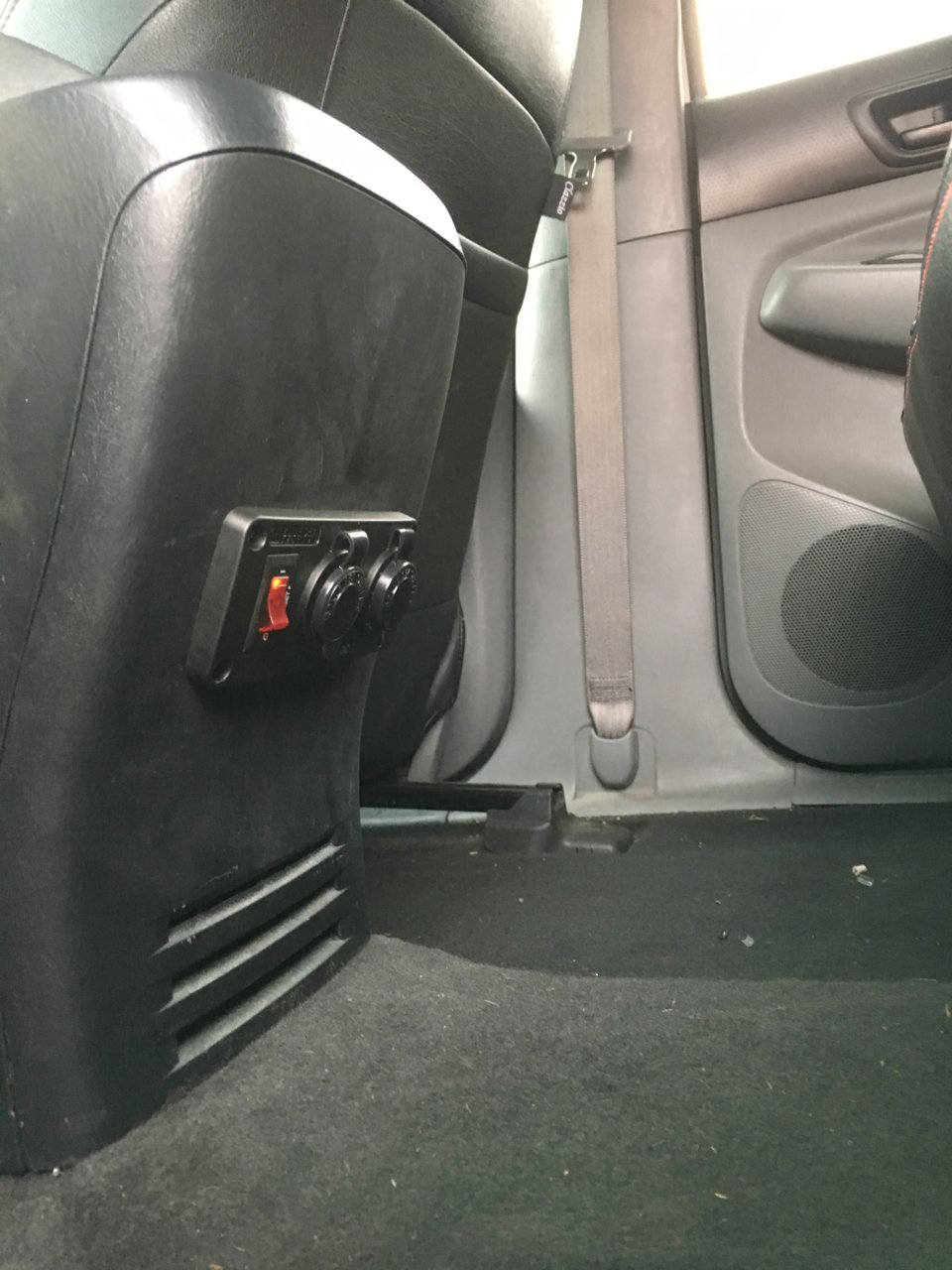

    Central Oregon
    PandaPandaPanda likes this.

    That's a really nice install but I was wanting to tap the power from the 12v outlet for my wireless charger. I'll probably go with Larzzz's idea of using an add a fuse.
    Trent_G[QUOTED] likes this.
