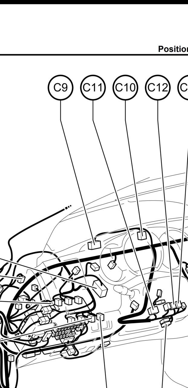

    I need to add the wire for the Cruise light at connector C9, pin 24.

    In case someone else needs.

    Yep, that's why I need to get to the back of the dash......... My wiring manual shows where, just not how. Go'in on 5 years now....... ;~/

    Pull the door sill, foot rest, kick panel, and e-brake cover(manual)/tray(auto). Then pull the lower dash (2 bolts and 3 clips). Then lower the steering wheel and pull upper dash (2 screw clips and 5 clips). 4 screws hold in the cluster.

    Green wire C9-21 to E7-18 mine worked after that. Literally nothing prewired on my truck. Had to run brown wire black wire and green wire to make work with handle.

    The light run was the easiest. 2 small phillips retainers above speedometer and the bezel pulls out. Combo plug on top left. Was super easy to run over to ecm. once I did that cruise worked. A electrical snake or similar can get you behind radio for run if you don't want to pull that out.

    Not if all you need is green light wire. Speedo cover pops out with wheel lowered and 2 top fasteners removed. Insert wire in c9-21 on top left can reach it easily. Fish wire to behind glove box insert into e7-18 . Done with light wire run. if you already did brown wire to e7 and black to ground you have completed the loop and CC will work. Will not work without green light wire attached.
