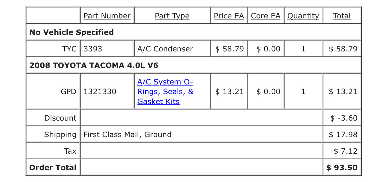

    Here’s what I bought from rock auto
    tyc condenser. Perfect fit

    two of them are for the ac compressor and two are for the condenser. I just removed the stock ones, matched them up, used some PAG oil and installed them. Should be a tight fit when sliding them on the hose.
