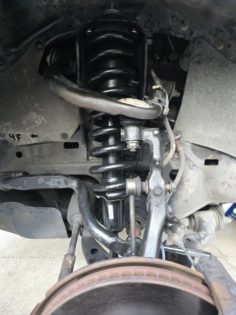

    Never insulted; working with computers, I have leaned how easy to is the miss the little things. Thankfully it was not that, and the right tools got me going.
    OK, now I know it's a small world; the wife is currently in Nashville visiting family!! :cool:
    I have yet to attack the dust cap for the next phase, but I made headway on the nut. PB blaster, and the extraction sockets made short work of it with no damage to the threads (tested with the new nut). Now I can get the swaybar out of the way and proceed!

    Stupid thing, no matter how many whacks doesn't want to drop free. If only I could find my mini sledge...
    Hit it with extra PB just in case. Hope I don't need a pickle fork...
    Edit 2.. finally.. take that you stupid knuckle (mine and the truck). No pickle needed. On to the shock

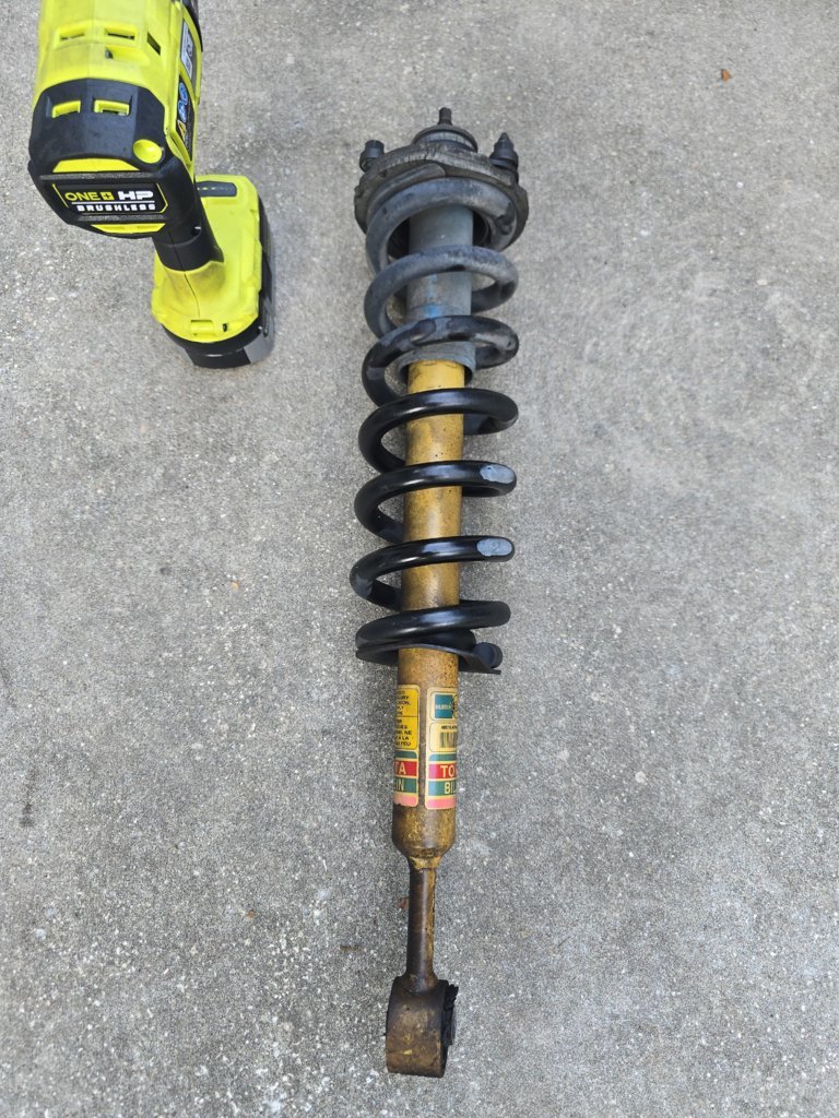

    Shock #2 is replaced. Pretty sure this guy is original to the truck.....
    Now, for reasons I don't understand, the same shocks are different colors, but i see that only AFTER installing everything. And you know what.. it's now her personality.. rofl..

    The black shocks are for the non TRD variant.
    yellow is for off-road. Blue is for sport.
    They changed blue for sport for 3rd gen I think to also black.
    yes the colors matter as they are different in valving from what I am told.

    So, regarding the shocks - the ones i purchased are these two:
    https://www.oreillyauto.com/detail/...-strut-and-coil-spring-assembly/msa0/32ty1100
    https://www.oreillyauto.com/detail/...-strut-and-coil-spring-assembly/msa0/32ty1101
    Interestingly, the website shows they are different colors (despite being the same just left and right)... Called the store, they have another one on order and we will see what color it is. Guy said they have seen the supplier change things, and one may be older than the other. Honestly, if they are functionally the same, I'm not going to stress it (no desire to tear things apart again).

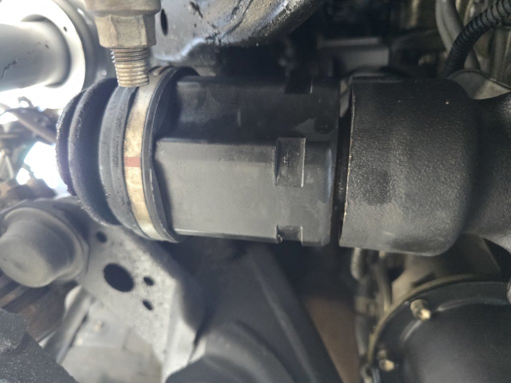

    Well, I got half the old cv out.....
    The half connected to the diff does not want to come out though.. got it budged about a half inch but damn it it doesn't want to go more...

    There’s a snap ring that holds the CV in the housing. Rotate the CV axle a little bit at a time and try to pry it out. Eventually you’ll hit the spot where it pops out.
